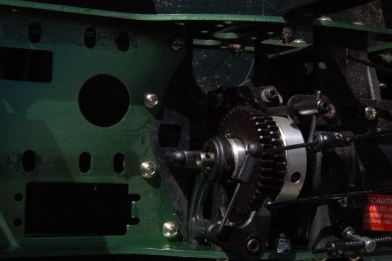

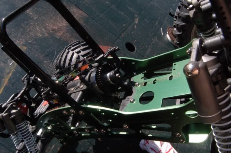

Here's a couple of pictures of a converted GST. It looks like the guy removed the tranny and just used the center diff spur;
Attachment 9159
Attachment 9160

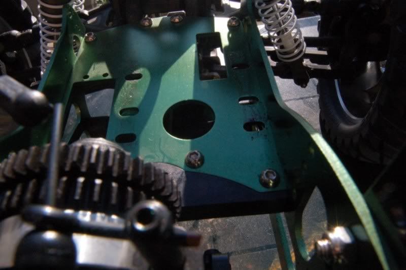

This is a pic of a conversion WITH the tranny;
Attachment 9157

bigsteel 07.21.2010 04:55 PM
The first 2 look rather well set up. The 3rd one not so much. I wouldn't listen to/ go off anyone elses design who mounts a lipo to the top of there cage,WTF?--Josh

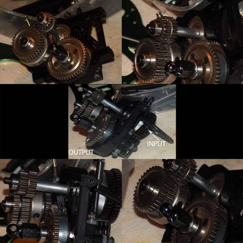

Got some pics of the GST tranny. Hopefully someone will remember a direct drive or something similar that will make this process easier:

brian015 08.03.2010 01:29 PM
Originally Posted by bigsteel (Post 374039)
I would try using the tranny locked in second (I didn't mean to say first gear sorry!) and make a motor mount out of some aluminum angle. Or email monster mike and see if he has a mount that wil work. And if you do destroy the tranny, then I'd try to find a way to use mikes universal center diff mount.--Josh
I agree, the worst that can happen is you destroy the tranny. Then use a center diff.
The pics show mechanical brakes are already set-up, so I, personally, would use them. They will save some strain on your esc with this heavy truck.

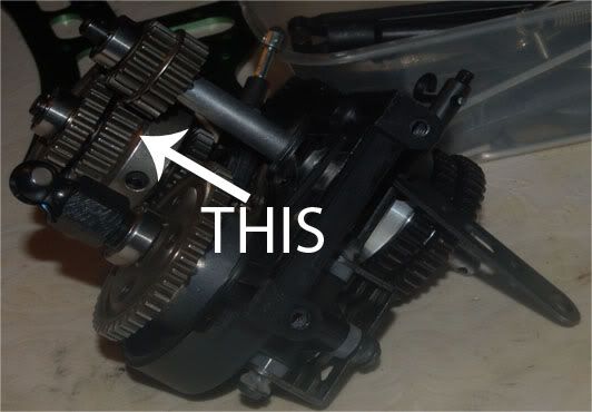

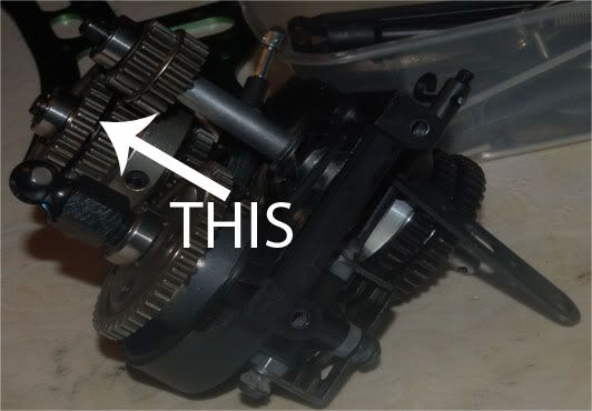

Here's the tranny;
http://i94.photobucket.com/albums/l8...ssionsmall.jpg
From what I can understand by looking at the Revo locking guide, I have to simply remove this:
http://i94.photobucket.com/albums/l8...STGEARTHIS.jpg
And just LEAVE this be, since the centrifugal clutch is already attached to the gear, which I assume is the SECOND gear?

bigsteel 08.07.2010 04:46 PM
You just remove the second gear,and LOCK the centrifugal clutch in the engaged position.and then your done.I still see premature tranny destruction even being metal under a 1717,then after your tranny goes bye bye,I'd contact mike and see what he has to say or try a savage style center diff setup.--Josh
