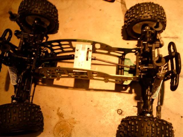

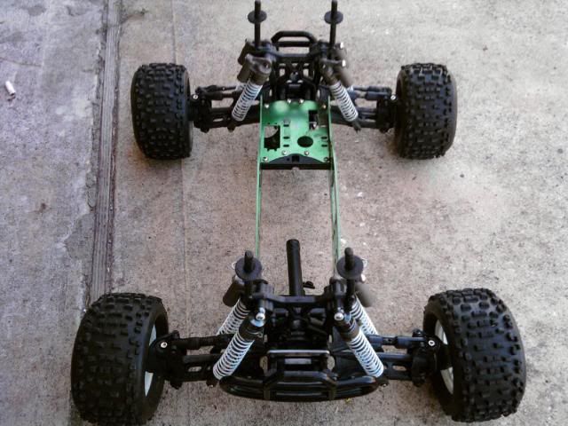

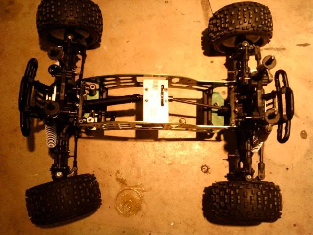

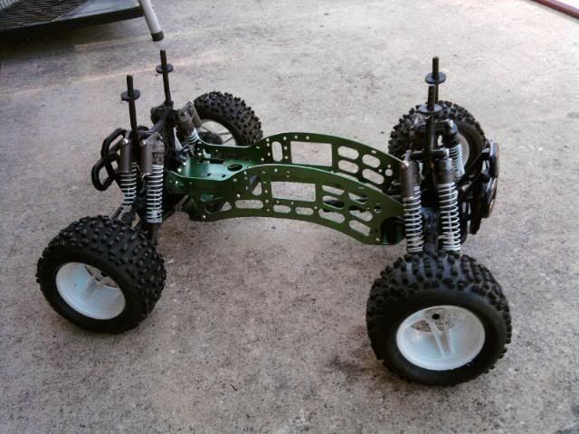

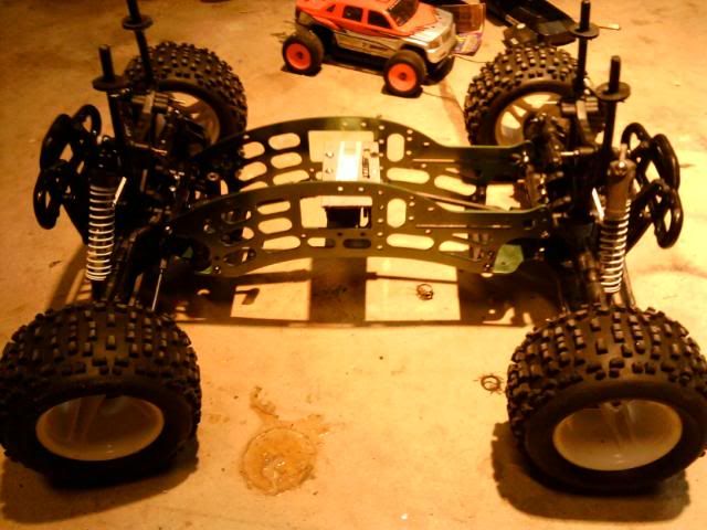

here are a few pic from tearing down a bit and cleaning. http://i39.photobucket.com/albums/e1.../Photo0172.jpg http://i39.photobucket.com/albums/e1.../Photo0173.jpg here is a mock up of posible mounting options http://i39.photobucket.com/albums/e1.../Photo0175.jpg http://i39.photobucket.com/albums/e1.../Photo0176.jpg http://i39.photobucket.com/albums/e1.../Photo0177.jpg |

I love those tires btw. Are those regular badlands? |
yes, the truck came with the stock 7.7s but i wanted to loose weight. these are ofna full offset wheels and standard mt badlands. i've had them for a long time but never really used them. i love the mean stance it gave the truck.
