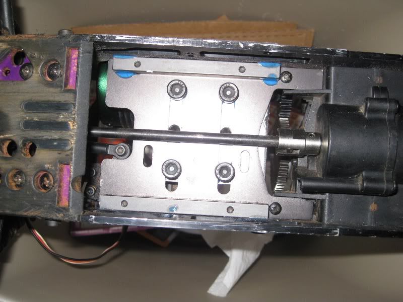

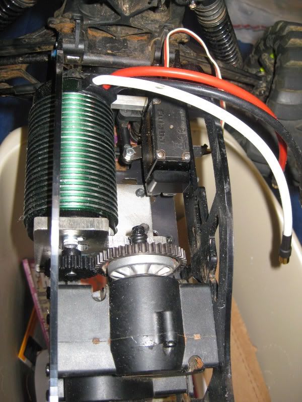

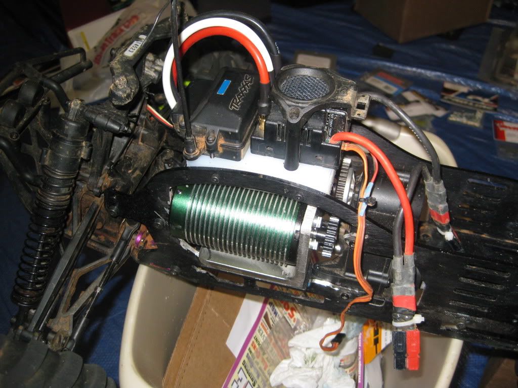

oh, didn't realize I never updated my own thread with my motor mount. Its made of out 1/4" SS.
http://i182.photobucket.com/albums/x...x/IMG_5413.jpg
http://i182.photobucket.com/albums/x...x/IMG_5414.jpg
http://i182.photobucket.com/albums/x...x/IMG_5415.jpg
http://i182.photobucket.com/albums/x...x/IMG_5416.jpg

Interesting, 4 wheel steering or is the motor in the front?
Bmr4life 12.16.2010 10:11 PM
motor in front.
lincpimp 12.16.2010 10:16 PM
Ok, how does it handle with the batteries in the back? Does it fly level under power?
Bmr4life 12.16.2010 10:24 PM
Its definitely more level with the batteries in the back. Before the 1717, I had the batteries up front in the boxes. This helped out with wheelies a lot, but was very front end heavy.
