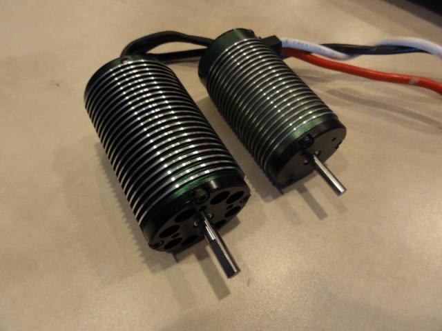

I ordered from the motor clearance sale on CC's website. Looks like I got the heli version of the motor. The rotor is larger than 5mm. I'm afraid I made a mistake or hasty purchase. Hoping Patrick or someone from CC will respond.
What do I do now? Can I send it back and trade it for the car version? Do I need to order a 5mm rotor kit for it instead?
I want to run this in my D8Te converted truggy on 6S. I have the EliteRC motor mount for it, and the motor seems to fit despite how much larger it is in diameter. Not sure what pinion options I'll have though.
The pic is side by side with a 2200kv motor.

Yeah, you got the air version. The air version has a 6mm shaft, vented endbells, 1500kv, and motor wires are extensions of the coils (and are stiff). The car version is 1580kv and looks much more like your 2200 motor, but bigger.
There were inventory/boxing issues with the air and car version at Castle. Contact them and chances are they'll do a swap with no problems...

I know this wasn't an inventory issue. It was my fault for not noticing the details of the item I ordered.
Have you been happy with the air version? Any issue with the holes in the endbells and dirt?
Worst case scenario I can just use a plastic spur and a alloy pinion drilled out to 6mm.
Forgot to mention that I emailed Christy at CC. I'm going to wait until I hear back from her before I do anything with the motor. Right now I'm leaning toward exchanging it for the 1520/1Y 1600kv motor if that is an option she makes available to me.

The air version has flats milled into the can that provided some extra clearance from the chassis. I'm not sure that without the milled flats that the 1717 will fit.

I did not use the air version. But really, aside from the larger 6mm shaft, there is no difference between the "air version" of a CC motor and a "classic" Neu motor. Lots of us used/use Neu motors in our vehicles with no issues. Most people cover the vent holes, and maybe find a way to help support the stiff wires from excessive flex (jump landings and such). Just a matter of convenience really.
