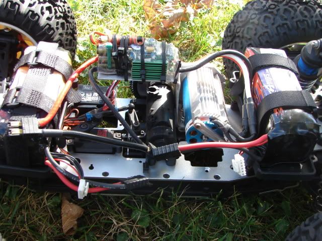

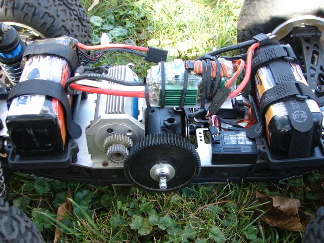

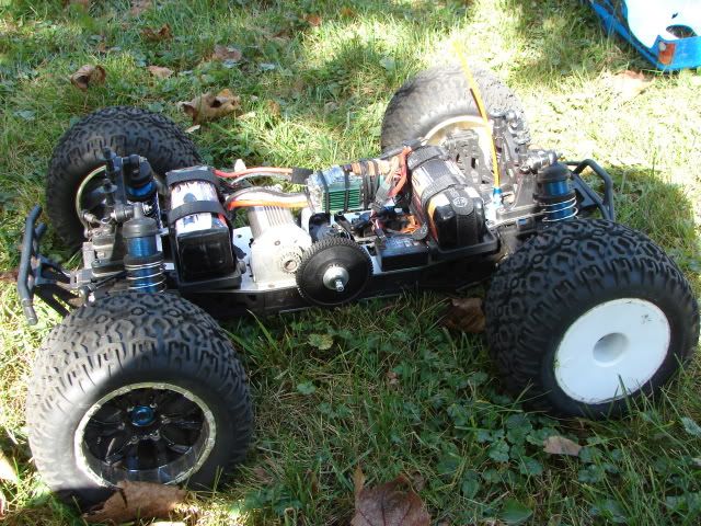

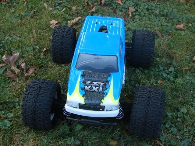

i though i would share some pics of the 12cell LST i have talked about afew times as of late
just the Facts:
its 15.4lbs RTR
the motor is a Medusa 36-80-1100kv
it temporally is powered by 2 max amps 5250mah 6cell lipos (they suck :whistle:)
the esc is a Castle Creations HV110
motor mount is made by The Dude and the motor uses a RC Monster clamp
it still uses the 2-speed
its geared 25/65 and the top speed is 64mph
the truck is mostly stock accept for the forward only conversion and Lundsford Ti steering turnbuckles
ok some time for some HV truck porn :yipi:
http://img.photobucket.com/albums/v2...L/DSC04239.jpg
http://img.photobucket.com/albums/v2...L/DSC04246.jpg
http://img.photobucket.com/albums/v2...L/DSC04245.jpg
http://img.photobucket.com/albums/v2...L/DSC04244.jpg
The LST is holding up to 12cell pretty well, as long as the slipper is set right, so far the only broken part has been a pin in the transmission, its going threw stock tires pretty quick lol
i will try and get a video soon

Nice layout there :yes: (aside from the flaming bricks on either end lol)

dude awesome rig! need to get rid of the paper weights with flames though lol. hobbyking has a good selection of lipos in stock in the us now. been using some 6s 3600 30c in my buggy and they run pretty strong. what kind of runtime we lookin at on ~ 37v?
Semi Pro 10.14.2010 02:40 AM
like i said the batts are temps, they were free so we used them, it will be getting hyperions at the start of next season (the season is over in afew weeks here no reason to get new batts just to let them sit)
