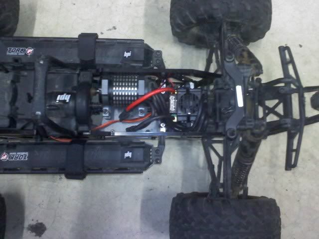

Got the esc mounting figured out, just went with doudle sided tape and a ziptie. still look pretty cool, but i dont know why HPI orders these motors with wires that are 6inches long, it would look a lot cleaner with shorter wires but i suck at soldering so the long wires were tucked down with another ziptie. I need to get an extension for esc because no matter what way i route the wire it will not reach the reciever, only by like a half inch though.

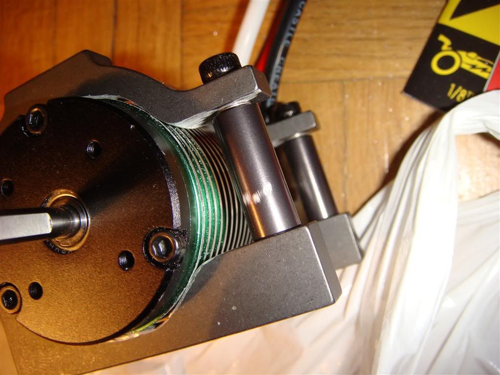

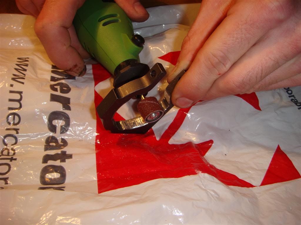

Well i got TVPs from GCM Racing and size iz XL, i grinded the HPI motor clamps/holders to fit CC motor..
Motor clamps/holder i marked like this
http://i643.photobucket.com/albums/u...g?t=1269304007

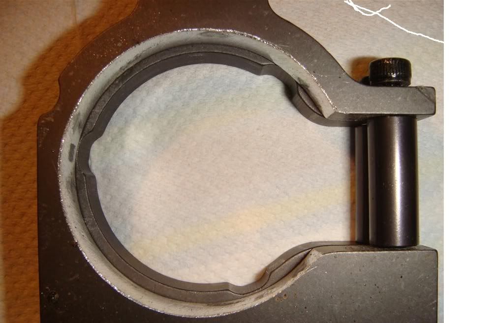

Grinded

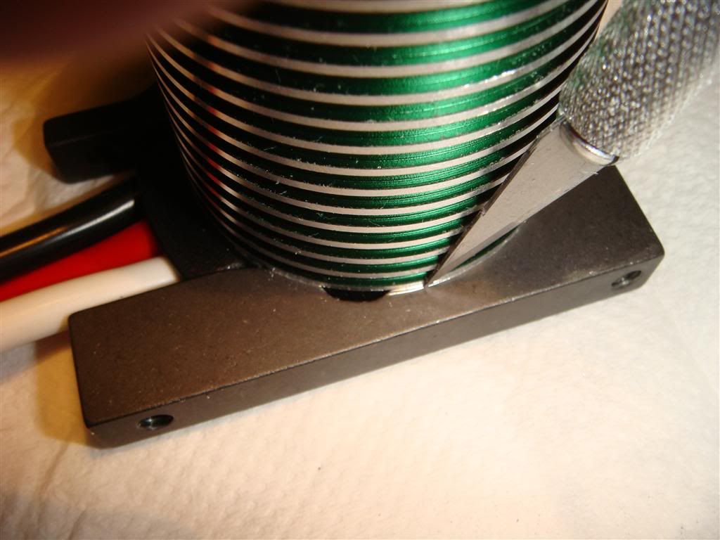

Here finished
http://i643.photobucket.com/albums/u...g?t=1269304008
One set of HPI clamps/holders where grinded for even bigger motor

CC Motor 1515 is 40mm and with fins is 42mm wich means 2mm to grind off on motor clamp or 2mm fins on motor... well i grinded the clamps as i didnt wanna grind the fins :no:
