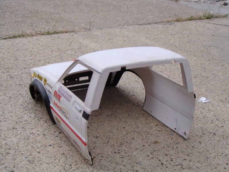

As for the body and tube frame for the rear thats beyond my skills so I'm calling upon our resident GSRCRC Club tube guru "JMZ" to help...
He managed to find this treasure in his bag of tricks...

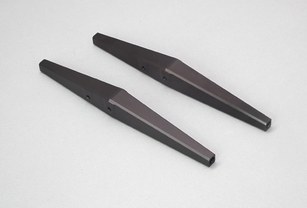

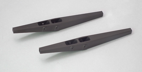

Think I might use these rear arms :)

I had to abandon the idea of using the CORR rear links - They are just too long and the MIP drive shafts were not going to reach...
Back to plan A for now... I did a lttle more work on the build. I purchased Vanquish Razor shock mounts and the Vanquish 4 link.
The rear links were also swapped out for titanium...
Its now been shipped off to the guy who's going to do the tube work.
