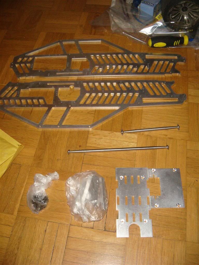

Here my Savage Flux Baja Build...
About the Flux Baja 5b kit :
-TVP's 5mm 7075 T6 aluminium
-battery plate & servo plate 3mm 7075 T6 aluminium
-3 battery mount positions
*In the TVP's
*In the battery box mounted to middle
*In the battery box mounted to the back
-Can take bigger motors like 1717 and 1520
-perfect size for Baja 5b body

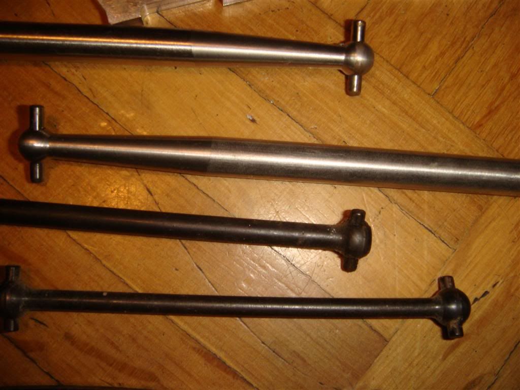

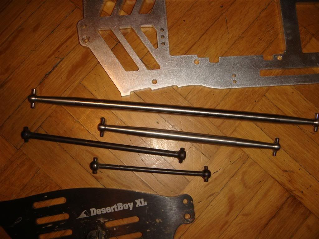

-DogBones (Custom made, stainless, fat, MF)..must say HPI DB look like a Lego toys vs. these bad boyZ!
http://i643.photobucket.com/albums/u...g?t=1291156497

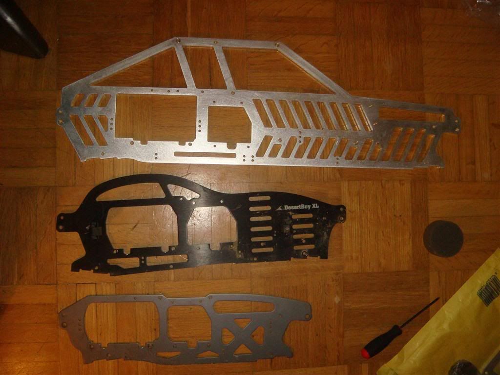

Stock vs GCM XL vs ALZA 5b TVPs..
http://i643.photobucket.com/albums/u...g?t=1291156499
And here...DogBones vs DOGBONES !
Just look at these Fat, BaD BoyZ
http://i643.photobucket.com/albums/u...g?t=1291158699
http://i643.photobucket.com/albums/u...g?t=1291156501

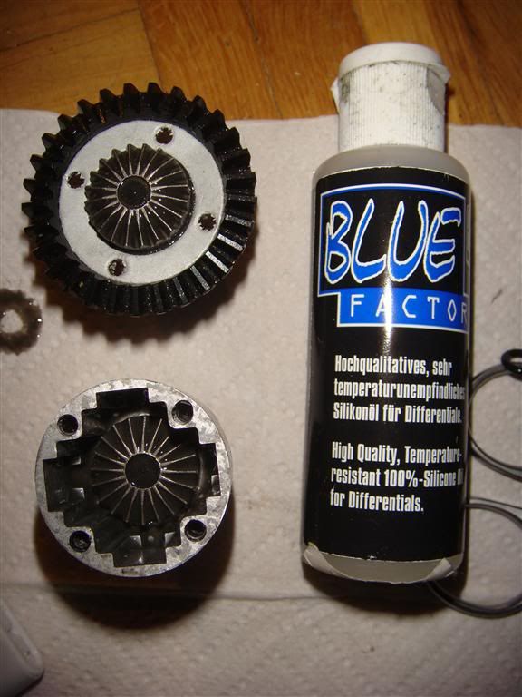

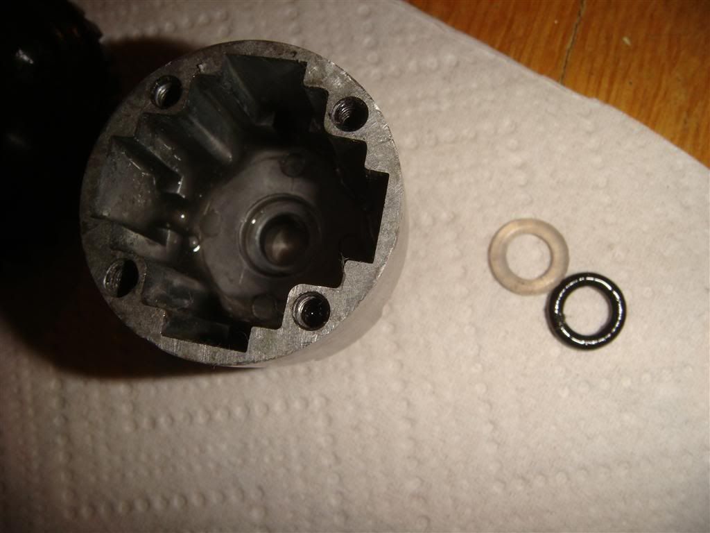

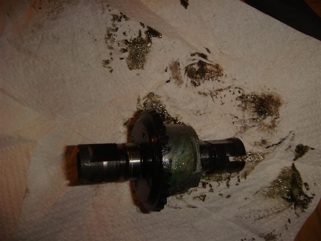

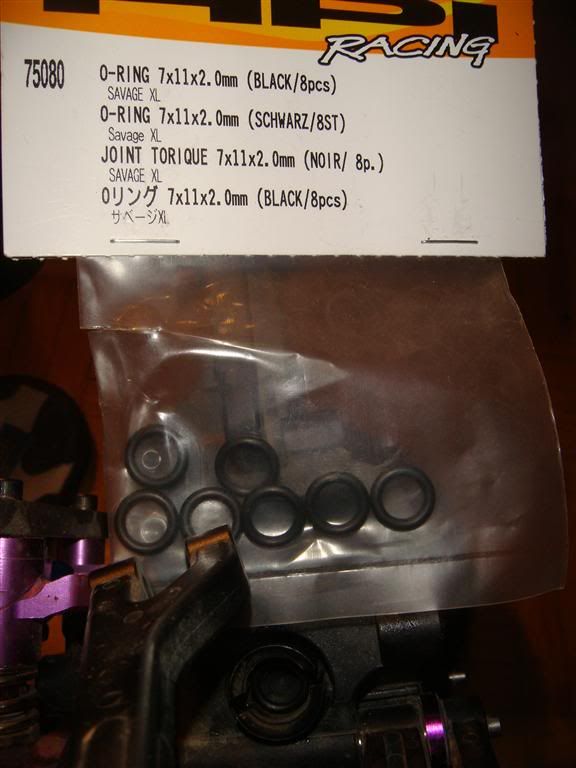

Front diff was leaking so i put it apart and also changed stock diff O-Rings for BAJA O-Rings...these fit better, dont know the part number...
http://i643.photobucket.com/albums/u...g?t=1291170938
http://i643.photobucket.com/albums/u...g?t=1291171268
White is Baja O-Ring and black is stock..
http://i643.photobucket.com/albums/u...g?t=1291170939
Changed the diff oil, i used LRP 50.000W in front and 30.000W in back !
http://i643.photobucket.com/albums/u...g?t=1291170940

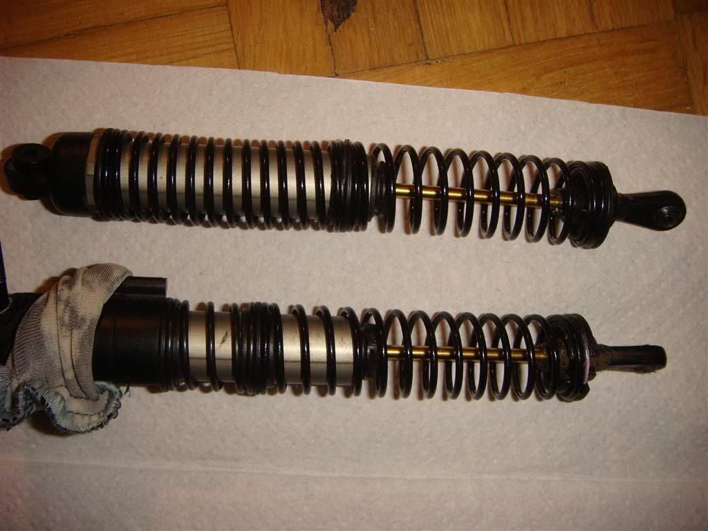

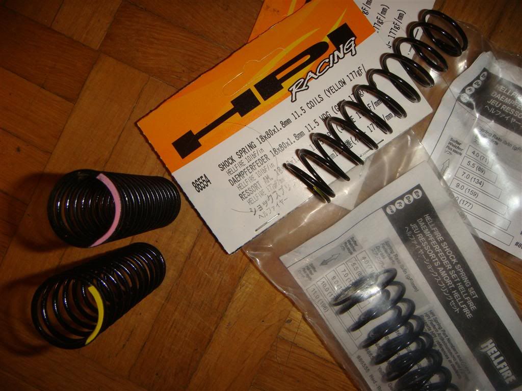

Changed stock springs "pink" for a rate harder "yellow"...
http://i643.photobucket.com/albums/u...g?t=1291171412
Here i was playing a bit with springs on shocks...Up is Pink+Yellow vs. down stock..for now i use just yellow springs but if to heavy could use both springs like showed on picture..
Also used O-rings in diff cup outputs...
http://i643.photobucket.com/albums/u...g?t=1291171413

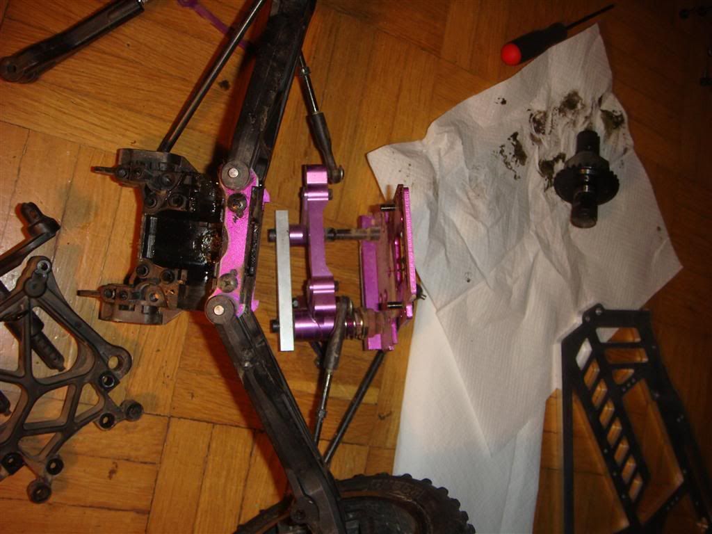

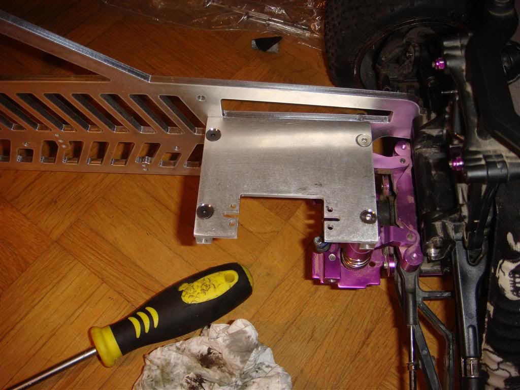

Servo plate i instaled first, than 1 side of tvps...
http://i643.photobucket.com/albums/u...g?t=1291183610

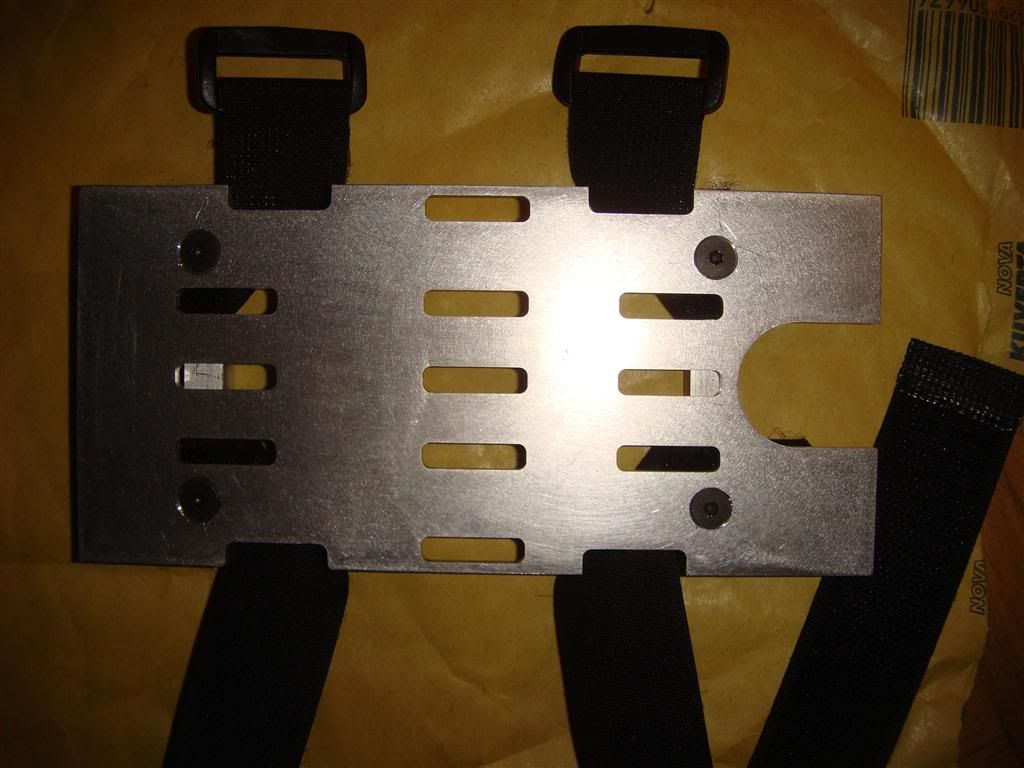

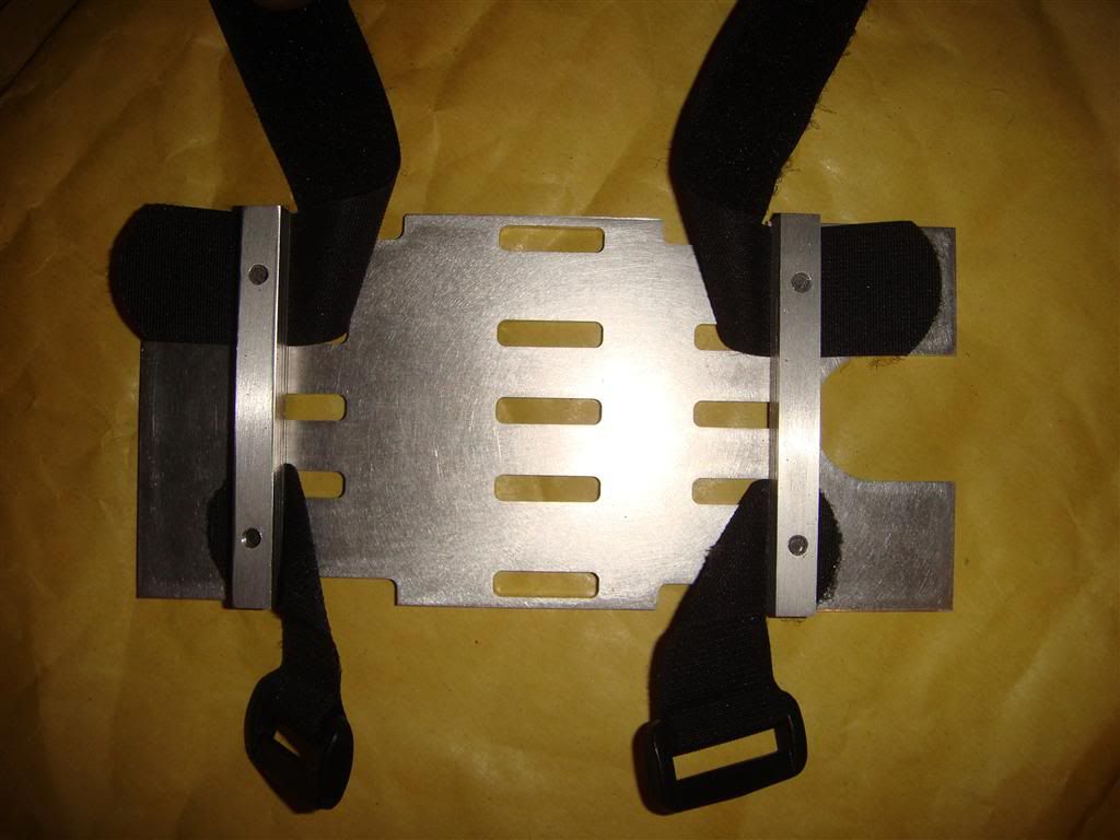

Than i went for lipo plate, i used Gorilla straps from RCM...and i installed those suckerZ betwen the bracles and lipo plate...pic will tell more.
http://i643.photobucket.com/albums/u...g?t=1291183611
:lol:

And a fast comparioson vs Body i had on GCM XL tvps....
http://forum.modelarji.com/datoteke/...custom_255.jpg

And here a pic, that slipped...
HPI A720 shocks with pink + yellow springs vs "down" HPI stock
For heavy loaded trucks..:lol:

Would probably be better off with a red spring and the plastic tube that comes with the stock shocks then that double spring? Would avoid that collar that rubs on the body of the shock at least.
I'm a bit dubious of those dog bones. The point where the shaft joins the ball is still the same thickness but the thick shaft won't provide much torsional flex and that could put even more stress on that join area.
