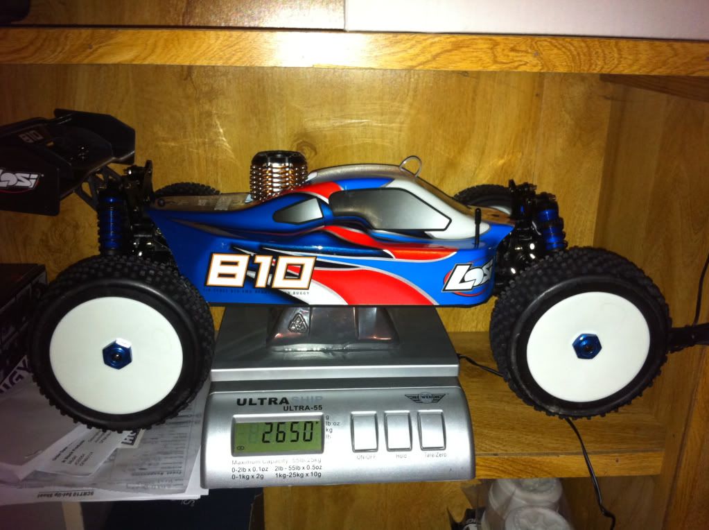

Just starting a thread on this project. Should be a pretty quick build. Just got the 810 yesterday. Gonna tear it down and do the conversion this weekend. I already have all of the parts sitting on my bench.

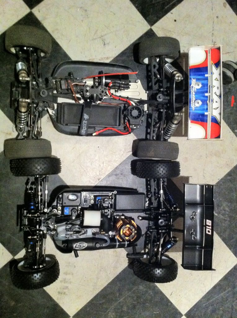

Wheelbase is about 1/2" shorter than my xray 808 with the 2010 chassis on it. Looking forward to seeing how it drives on the tight indoor track.
Plan is to run a Tekin RSpro, Novak HV7.5 motor and 3s Hyperion 6500 pack and the RCM Ten-T conversion kit.
Here are a couple quick pics before I start tearing it down.
