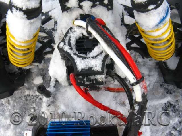

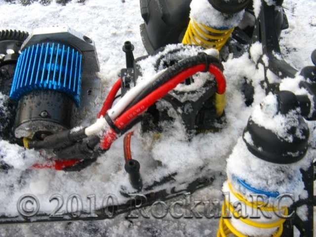

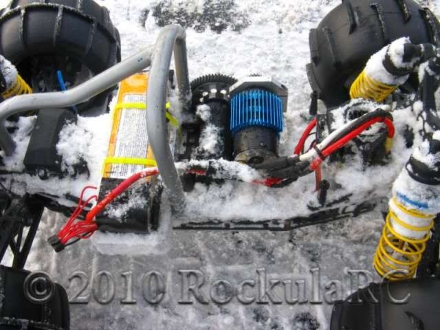

Ran my E-XXL in the snow this morning and it was awesome. I didn't get full on into deep snow or anything like that. Just in a parking lot. I was curious to know whether or not this amount of snow was acceptable or unacceptable? I know that the MMM isn't waterproof, but I've heard many times that it's resistant to water around it... just not submerged. There is NO WAY that I am going to make up some stupid looking plexi-glass housing for it, and I don't like the idea of smothering it with a shower cap or balloon. This is a high-powered set up and I don't want to invite temp spikes. I'm not all that jazzed up about waterproofing it either. Basically... if it looks stupid or voids my warranty, I'm NOT going to do it. I'd rather just not drive the truck in snow if that were the case.
Thanks!

I love it how you can't see anything with regards to my chassis. LOL!
DrKnow65 12.13.2010 06:04 PM
That qualifies as submerged. You're either going wo waterproof it and void the warantee, or end up paying for repairs out of pocket from water damage.
Just saying that's as wet as anything you'd expect to smoke an Esc. Remember it's a heat source so where you don't see snow that's because it's water sitting in the bottom inside the case.
Sorry to rain on your snow day :-)

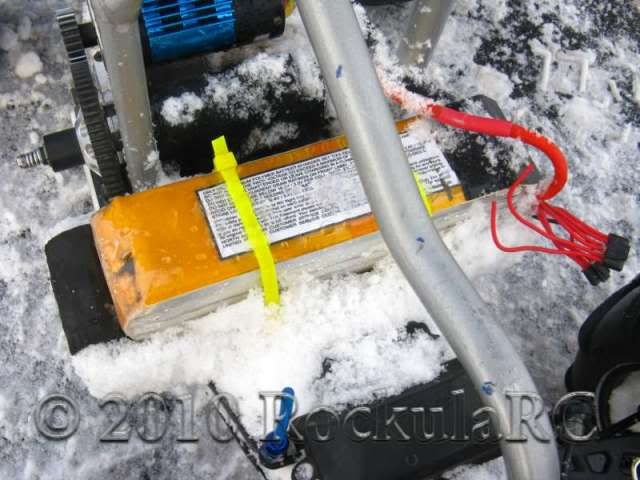

How did you get that e-revo RX case to look so nice sitting in front on your XXL?
BTW it looks like there are no holes in your chassis?
There is also something fishy going on with center skid plate too.
And finally, is that a custom CNC aluminum battery tray made out of 7075 your running that mounts from the bottom so that you cant see any of the screws?
I do like the custom sliver colored grab handle that you installed so that your "office" fingers dont have to get cold touching the snow.

Doo... interesting observations! I'm not at liberty to say anything about my chassis at this point. But let's just say "it's all in who you know". That "Grab Handle" is very handy. It's a modified New Era Roll Bar for the Nitro LST. It's AWESOME. Bondo did the mod for me. Whatta guy!
