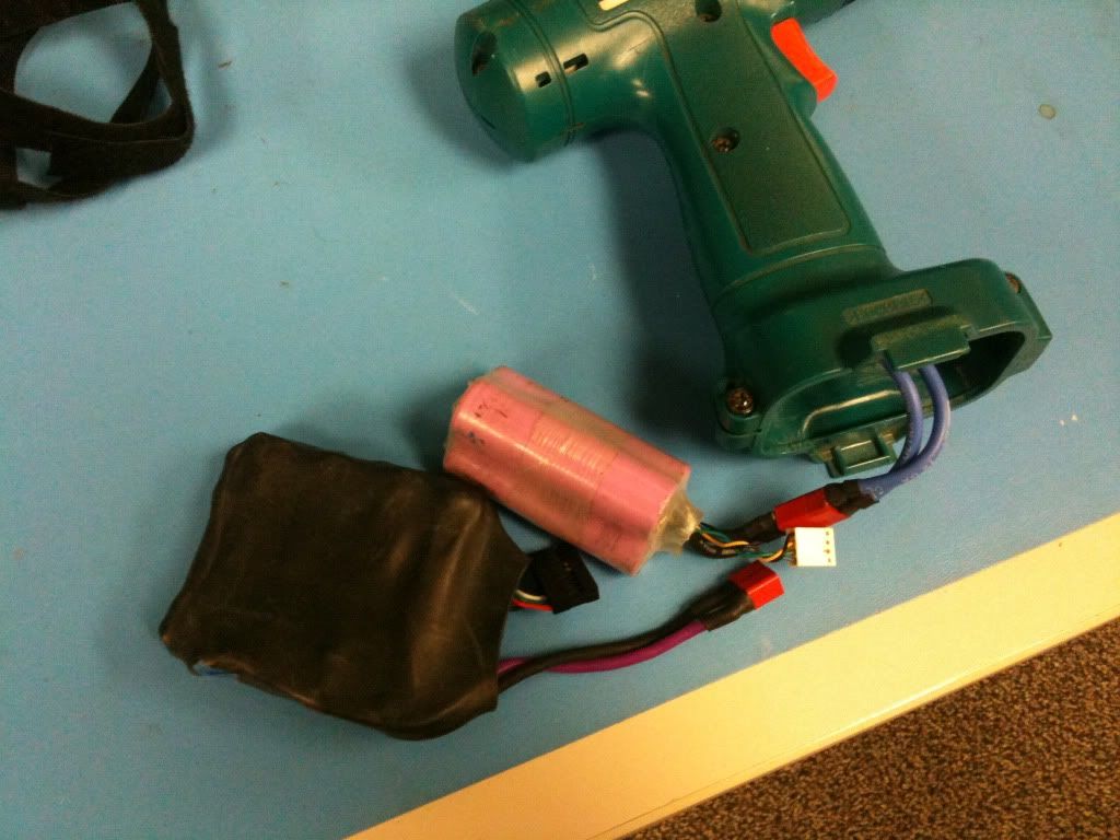

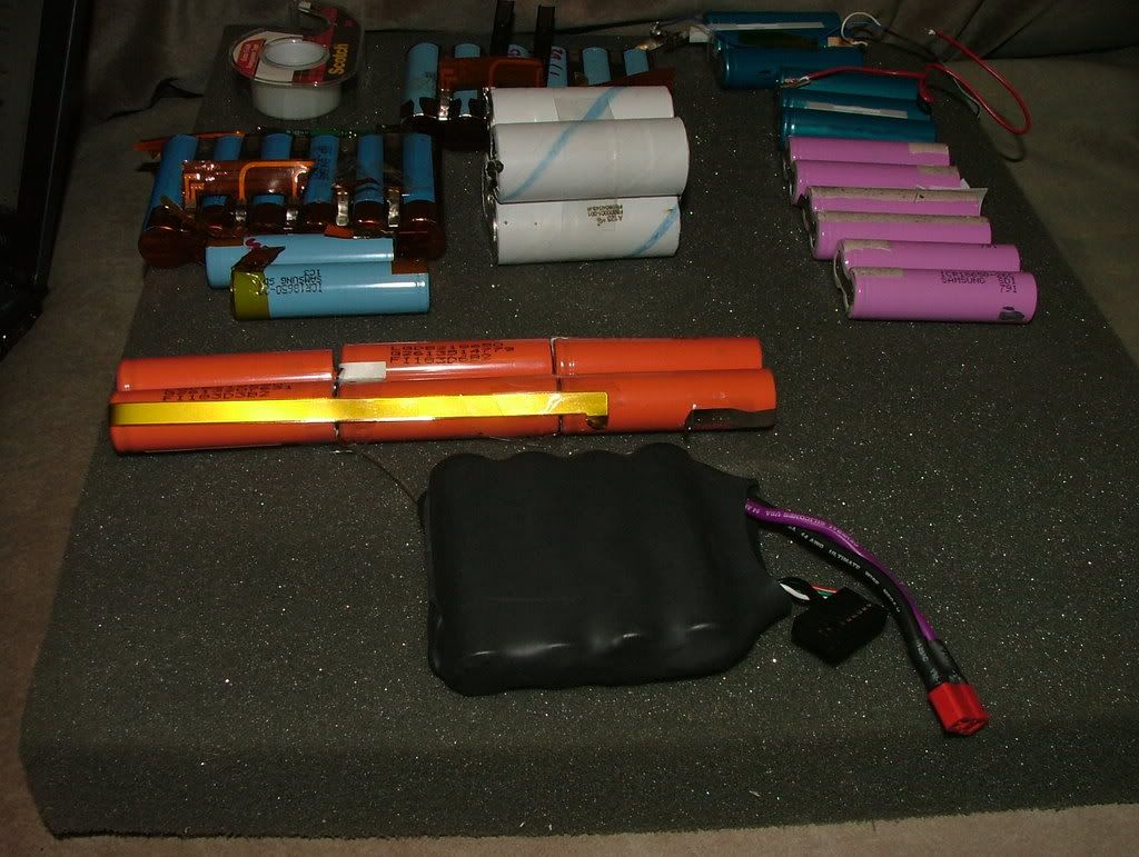

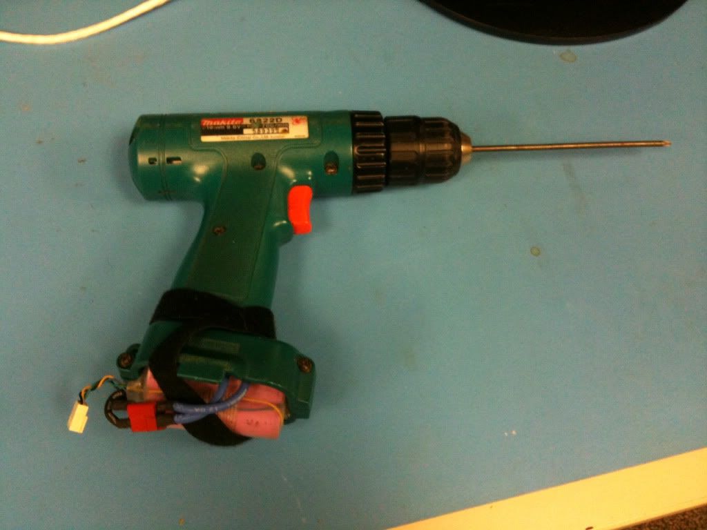

Some of you know that I've been using laptop batteries for a number of things. From Flashlights, RC, Power wheels, Transmitter, Receiver, and rumors of breast pumps.
Well I have a cheapo chinese drill with even cheapo nicads. Also have a 12 yr old Makita drill with bad batteries. So instead of buying some overpriced nicad pack to replace them, I opted to use the 18650 laptop batteries. I have a choice of 3s or 4s on the Makita, which was originally 9.6V. Son of a monkey is one powerfull setup now. The chinese drill got a 3s2p pack, for really really long run time when I polish metal pieces. http://i189.photobucket.com/albums/z...y/IMG_0247.jpg http://i189.photobucket.com/albums/z...y/IMG_0249.jpg http://i189.photobucket.com/albums/z...y/DSCF3697.jpg |

I've been playing around with several varieties of the 18650's also. I see some samsung 2600mah cells in your picture. The only thing you have to be careful about is not to exceed their max discharge ability. Most regular 18650's will top out at around a 4 amp draw. If you take a look into the cordless tools of today, you will find several high discharge varieties of the 18650. Makita uses one that can be discharged up to a 25 amp draw. Here's a link to show you some of who's using what when it comes to power tools. I hope you enjoy it. http://dewaltownersgroup.com/index.php/topic,204.0.html |

The ones I use are 5A cont and 45A peak. That is with the datalogger. I wouldn't be playing with the cells if I didn't get the packs for free. |
