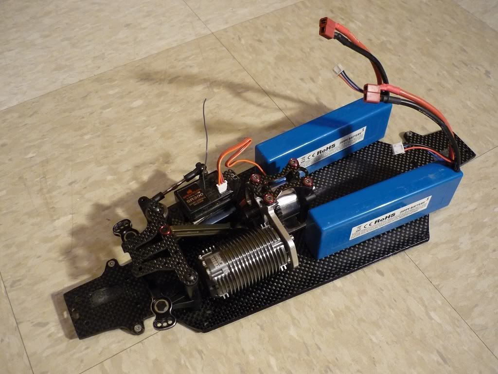

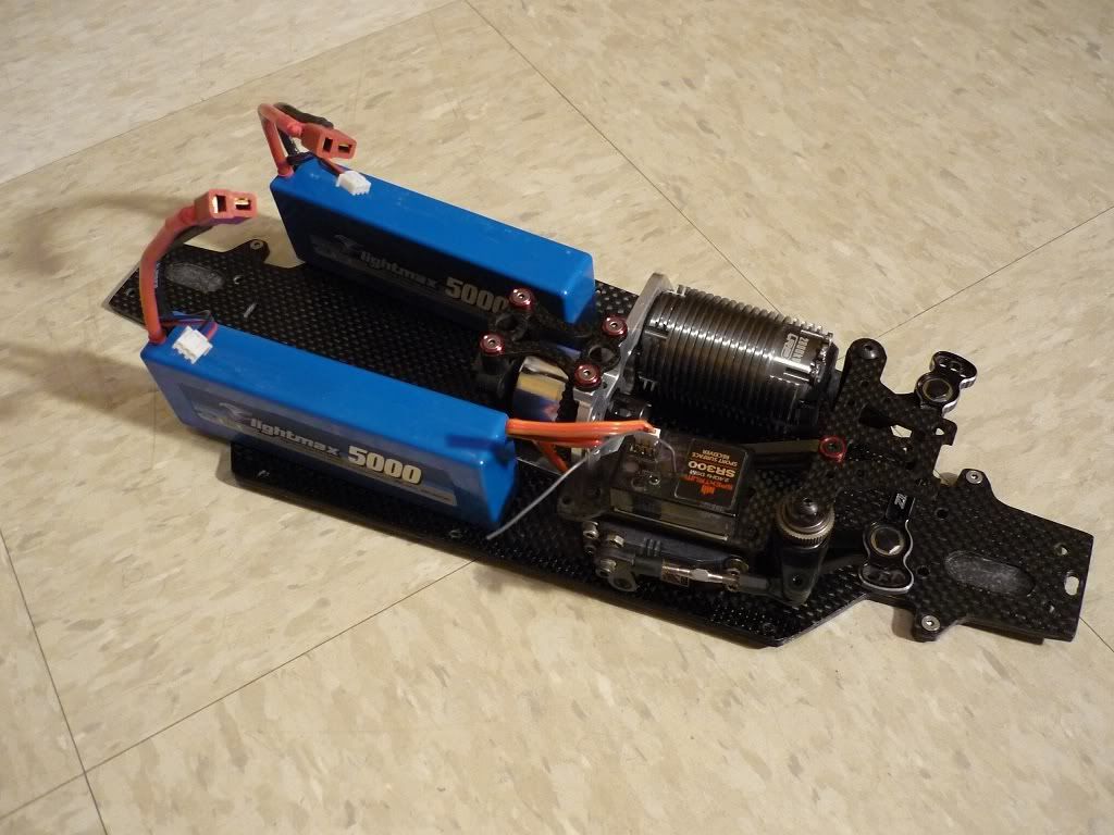

Finally putting to use the Moos Racing CF chassis I've had for awhile now. Been collecting pieces for awhile now and finally starting to put it all together
Tonight I built up the diffs, alloy cups all around and hardened steel internals. 50k front, 100k center, 30k rear. For the center I have the Slipperential and built up a standard center diff also.
Rebuilt the shocks. There will be Hyper 9 17mm front big bores and all 4 corners, internally limited, 60W oil and firm springs. Stock pistons to start out. Using X2 CF front tower, and modified X2 CF rear tower. Trying to lay the shocks down quite a bit.
Bought a new steering rack on Ebay and put it together with a Kingheadz ackerman plate. Trying to put some red accents with the concave washers and red bearing seals (don't see much of those though).
Only pics I took so far are kind of a mockup of the layout, still need to make an ESC rack to mount on the back of the center diff. Also still waiting on NEXX8 lipo trays and Kyosho IGT body mounts and front bumper.

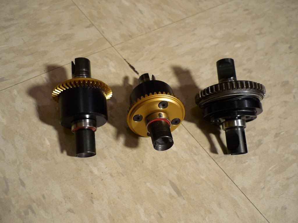

Here's the diffs. Innovative RC alloy cups, HotBodies hardened steel internals, Ofna hard-coated alloy bevel shafts, and Sportwerks TiNi ring gears.
The Slipperential needs a rebuild and I might rebuild it with one of the Delrin spurs. As of right now the regular center diff is going in.

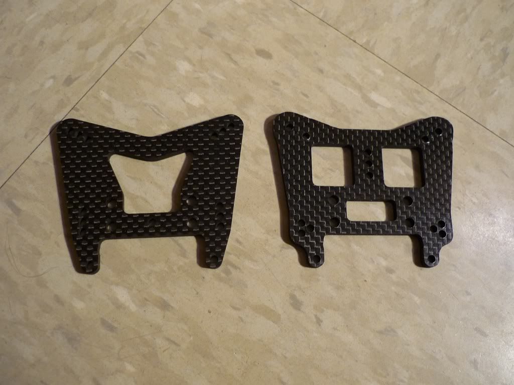

Second pic is the shock towers. Stock X2 CF front is on the left, and the modified X2 CF rear is on the right. The rear is now about the same profile as the front with same shock mounting positions.

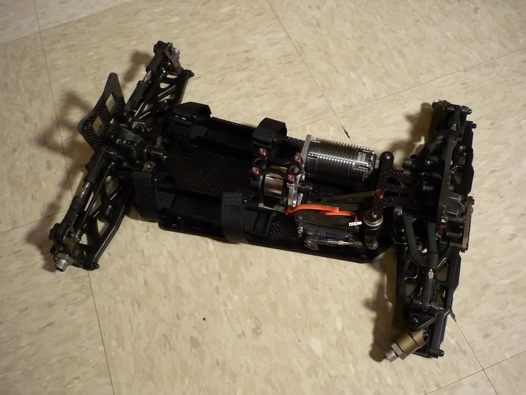

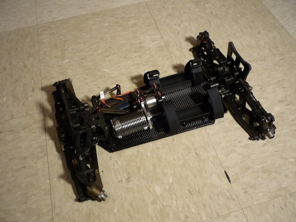

Got everything built for the most part. Just need to drill and countersink the mounting holes for the NEXX8 lipo trays, and wait for the bumper and body mounts to show up.
Unfortunately it's going to be awhile before I can drive it because I live in the Arctic circle, but that's plenty of time to save some cash and pick out a nice body.
