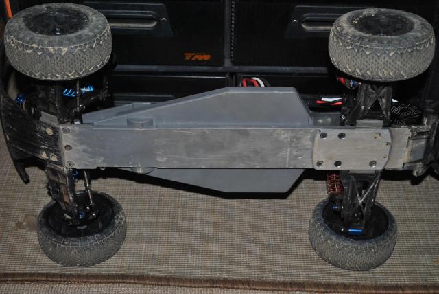

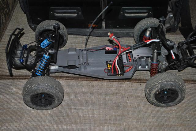

Had an old two wheel slash layin around and my 4 year old daughter has been telling me she wants to start racing for a while so for christmas I ordered up the STRC LCG conversion and the rustler upper and lower chassis and a battery strap(which i could have lived without by fabing one out of CF but oh well). The fit and finish was good enough for me, but the online instructions were not my favorite. Would have much rather had a piece of paper in front of me to look at but minor details. Went together pretty easily and looks more like a racing type RC than the slash ever did to me. Runnin the TRX 2.4 radio(which rocks for little kids and small hands) a airtronics 360z servo, and the centerpiece a mmpro and 4-pole 4600 kv motor of course!:mdr: geared 27/84 on 2s and the thing flies! will have tone it down with the max throttle setting for her or just put a 13.5 in it. Overall the conversion really woke the truck up. It dives into corners without heasitation, holds a line as fast as you want without the rear stepping out, and jumps really flat. Bumps are not so great at the moment but i think an oil change in the rear will take care of that. Overall i would definately recomend this conversion for anyone looking to resurect thier slash for some racing action. Total cost was around $60 shipped and about an hour to install it. Oh yeah about the name, its a slash with a rustler chassis, RASH was my take and it kinda stuck.:lol: Have seen quite a few of these at my local tracks and will be expecting to see more.

I just got the same kit and am sorta happy with it. I'm not a fan of the 2wd Slash at all (mainly because of the crappy diff), but it wasn't selling so I had to do something to make it acceptable. If you are running the stock setup, it's a pretty easy change over (I agree with you about the crappy online instructions).
But since I have an FLM tranny, RPM shock tower, and using a battery that wouldn't fit, the kit needed a couple mods. First, an extra set of countersunk holes had to be drilled in the STRacing aluminum lower plate due to the way FLM made the tranny. Second, I had to make a new set of standoffs because the RPM tower is thicker, so it made the upper plate angled down (this is nitpicky since you could just crank it down and be fine). And three, since I'm still running 4s 5Ah cells on a 2200kv Medusa, I had to mod the tray a bit to add some length to fit the pack.
I'm still using a JBWelded diff, but it still does drive better on corners, especially since my battery pack has to sit on-edge, which raised the COG way too high with the stock chassis.
slimthelineman 01.18.2011 09:38 PM
Yeah I noticed how the rear upper plate didn't like the rpm tower but I don't care. The battery tray is pretty damn tight, and the diff works better if you seal it up. Put 7k in mine since doing it and it's not leaking yet. Sounds as if your truck is a little more "max power" style than mine. Built this one for club racing so had to keep it legal. Will try to get a vid next time I go to the track.

Had a chance to race the rash agaian Friday night at controlled chaos raceway in Palmdale. Nothing more really to say about the 1406-4600 other than it rocks! Track was bumpy with medium traction but the truck was awesome. Sealing the diff and filling it with oil is probably the best upgrade performance wise for the slash based vehicles. Makes the truck much more consistant everywhere on the track. Got the shock setup pretty close and ditched the front swaybar for this track. Steering was awesome and forward bite was great too (due to the diff mod). The converted chassis handles great could carry through the sweeper at over half throttle and would square up nicely on power. Jumps alot flatter than the slash ever did but I've noticed it has quite a bit of rear weight bias. Not really an issue but had to lighten the front damping to get it to act right. All in all it's much more capable as a race truck. Had an easy time keeping up with the sc10's and kyosho's. With a little more fine tuning I think this will be a competitive 2wheel sc truck for me. I will say it again though seal the diff and fill it with oil, without this mod the truck just doesn't stand a chance on the track.
