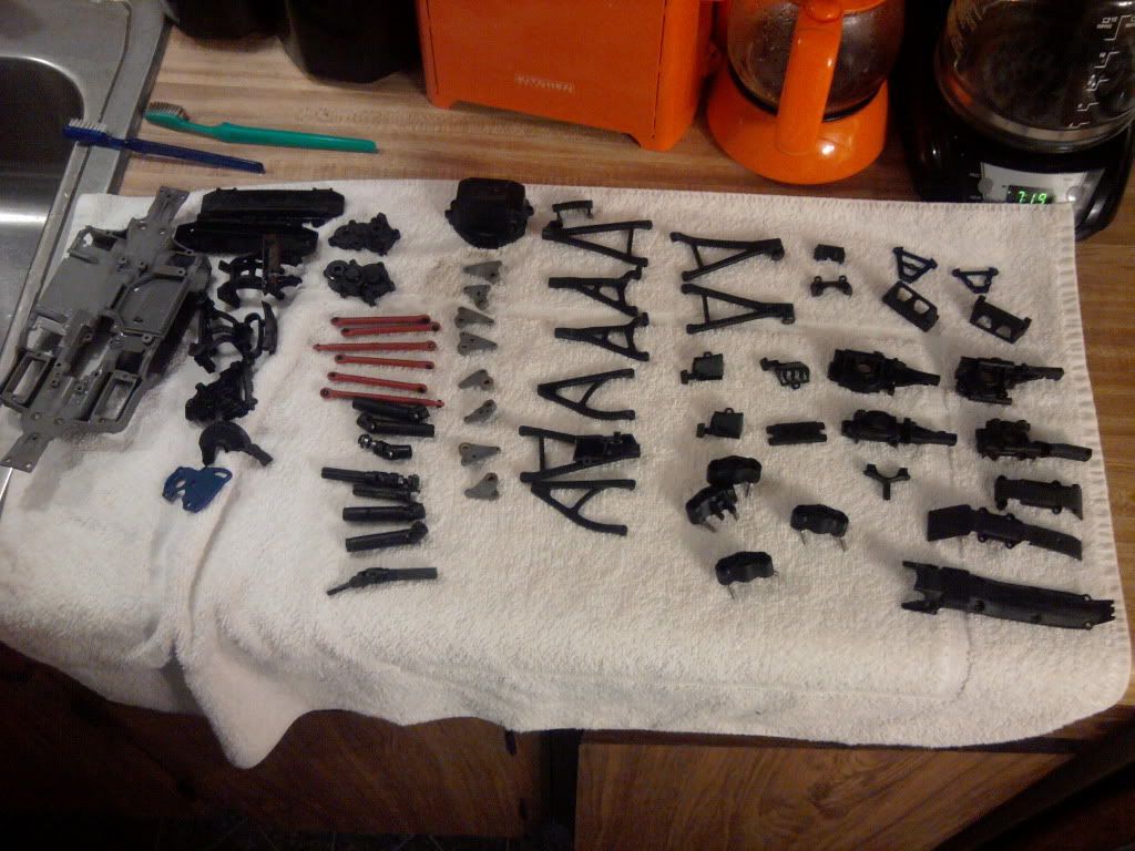

trev3813 03.05.2011 09:06 PM
Ended up being the esc. Got it warrantied. :D
Pic of it.
http://i191.photobucket.com/albums/z...305_192028.jpg
