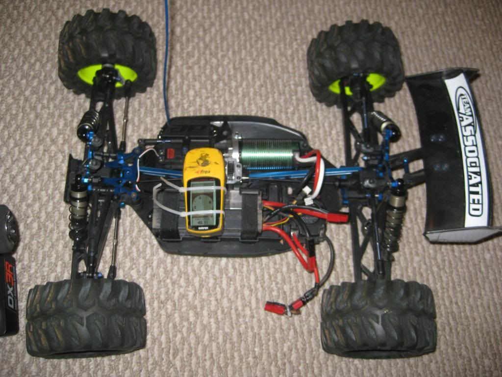

Here's a picture of the setup on 4s.
http://i182.photobucket.com/albums/x...s/IMG_5941.jpg
