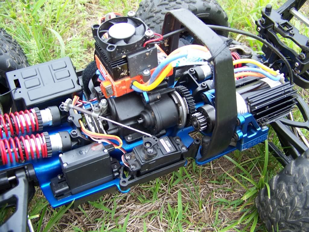

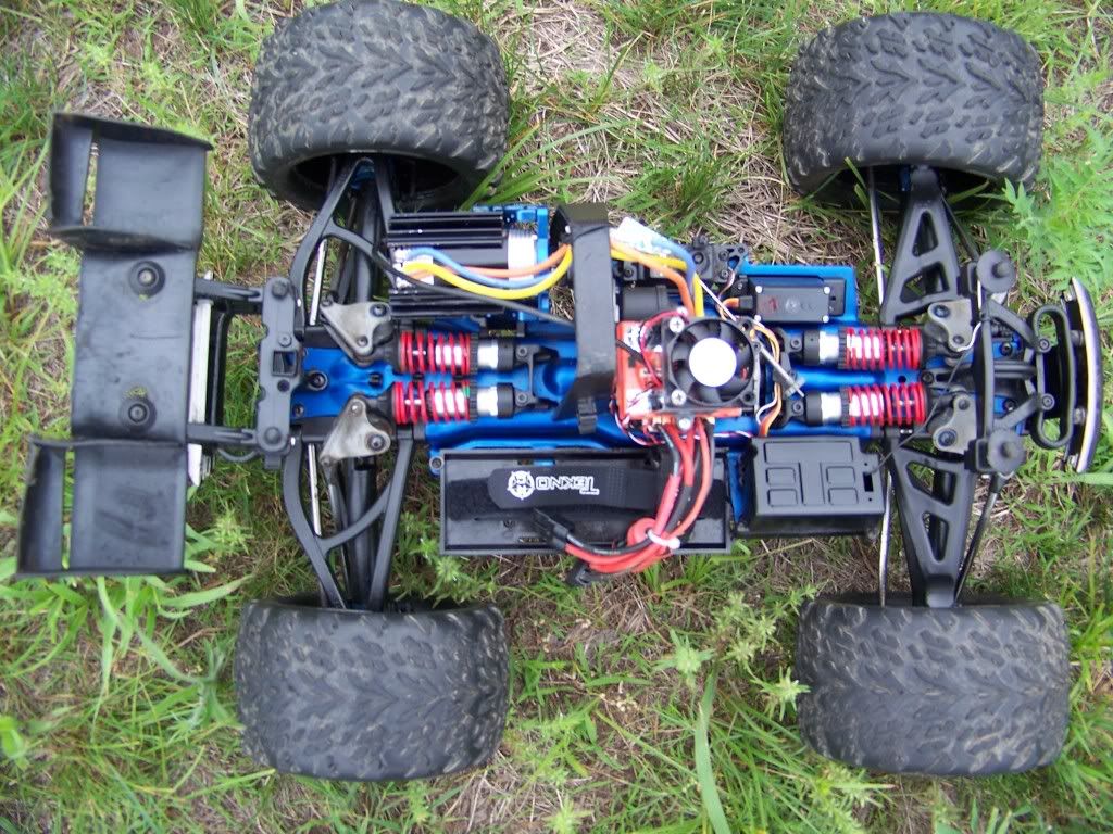

timaneli 12.18.2011 03:57 PM
i finally finish the conversion and spent no money do it on buying conversion kits or parts.
i made a custom motor mount, a custom battery tray and a custom esc mount.
my goal was to keep things well mount on the chassis and as light as possible.
some pics:
http://img194.imageshack.us/img194/6604/sam6333.jpg
i use a jconcepts illuzion body.
http://img52.imageshack.us/img52/1038/sam6343o.jpg
http://img683.imageshack.us/img683/4647/sam6335.jpg
i use a ezrun sc8 combo on single 3s lipo geared at 13/48.
http://img40.imageshack.us/img40/5807/sam6337.jpg
for battery i cut a plate tu put the battery tray without having flexing issues and to keep lipo close to chassis.
http://img850.imageshack.us/img850/9913/sam6338.jpg
http://img687.imageshack.us/img687/3080/sam6340.jpg
for the motor i use a 4 mmīs steel plate.
since ezrun esc is small i was able to put it between front shocks mount and the gearbox.
it was the best place i found since i donīt want a esc stucking over other parts.
for the receiver i use a traxxas stampede 4x4 water proof box and put it on the place of one of the steering servos since i use single servo setup.
i use all stcok screws places to put custom parts and the only holes i done was for the esc mount.
also with this parts location i can upgrade the chassis with front and rear sway bars and i can change or take of any part without having to remove others.
the car is running between 35 and 40 mph and that thankīs to the 2700kv of this 4 pole leopard motor and without anything heat up and i also have center diff that i want to take of because i only bash and this center diff is taking some speed and power from rear wheels to front ones.
i am waiting for e-revo shocks and some aluminiuns plates and that is it for now.
with lipo and ready to run the car weights 9.24 pounds so it is way lighter than a e-revo loaded too.
i had a e-revo on 4s on past but this baby is way better!!
hope you guyīs like and after i spent 3 packs today i just want to bash more and more!!
greetings
