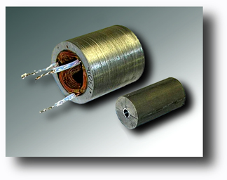

2 Attachment(s)
Koford seems to wind their 4-pole slotless motors the same way the R/C slotless 2-pole motors are wound.
Pdelcast 05.24.2011 05:34 PM
Not the same ...
To do a four pole winding, you need either a 6 slot salient pole winding or a 12 slot skip-2 winding.
To do a two pole winding, you need either a 3 slot salient pole, or a 6 slot skip-2 winding.
There are other winding possibilities, but you can't take a four pole winding and just throw a 2 pole rotor into it, or vice-versa.
