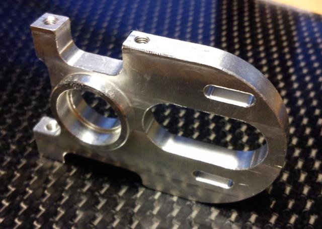

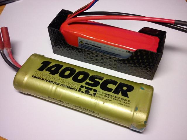

Attached are pictures of my self-designed aluminium motor mount and self-made carbon prepreg battery holder.

Even though some of the electric buggies are a bit heavier than their nitro counter parts, what makes the electric conversions so popular is the sheer acceleration and torque of the brushless set ups. My electric truggy is heavier than my friends nitro truggy although he tries, he cannot keep up with mine. So if they are a bit heavier it can be more than made up. However, the lighter you can keep it the better for sure.
Nice job on both pieces.

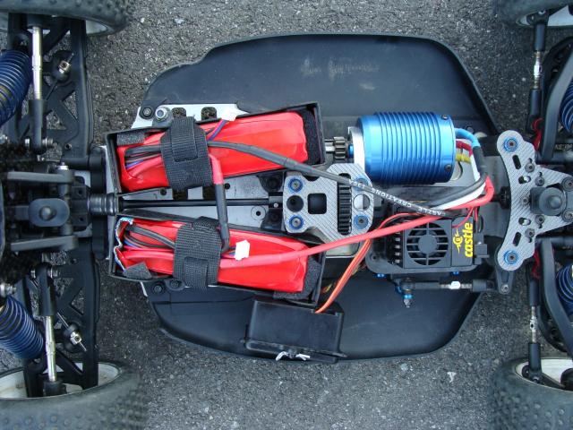

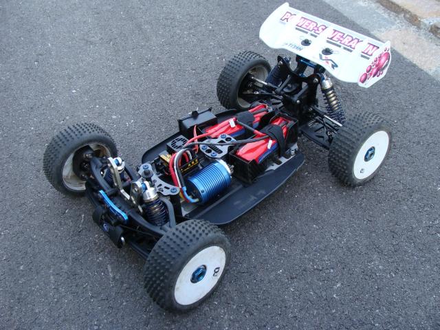

3 Attachment(s)
I thought this thread needs some more pictures. Here she is just before the shakedown today:

Can you tell us which buggy that is, and the turn/kv for the motor? How many cells are you running it on? Thanks
Thomas G
Thomas 05.26.2011 04:23 AM
Hi Thomas
Yes of course, here you go.
Buggy: Very old TTR S3 EB4 with an aftermarket flat chassis plate
Motor: Tekno Neu 1509/2y/f (1820 kV)
ESC: Mamba Max Pro
Batteries: 2x 3s1p (-> 6s1p) Kokam 2400 mAh 30C
I will probably switch this powertrain over to a new buggy next year (if it works well). Will have to see which one fits the layout, or make my own chassis plate.
simplechamp 05.26.2011 09:16 AM
Can you please tell me more about the carbon battery trays? You made them yourself? What was the process?
Thomas 05.26.2011 05:19 PM
Hi
Yes, I made them myself, at the university where I study. I used carbon prepreg, in this case twill with roughly 200 gsm. For the battery trays, I used a positive mould (plug) made of wood, which I simply cut to the size of the batteries plus some additional space. I used release film and laid three layers of prepreg onto the mould. Then I put them in a vacuum bag and into the autoclave at 2 bar pressure and 130°C to cure for two hours.
One battery tray (without velcro strap and double-sided tape) weighs 25 g. The carbon stripes for mounting with screws are glued on.
I will try to go to the race track tomorrow, to find out the runtime, but the weather is a bit unsure.
