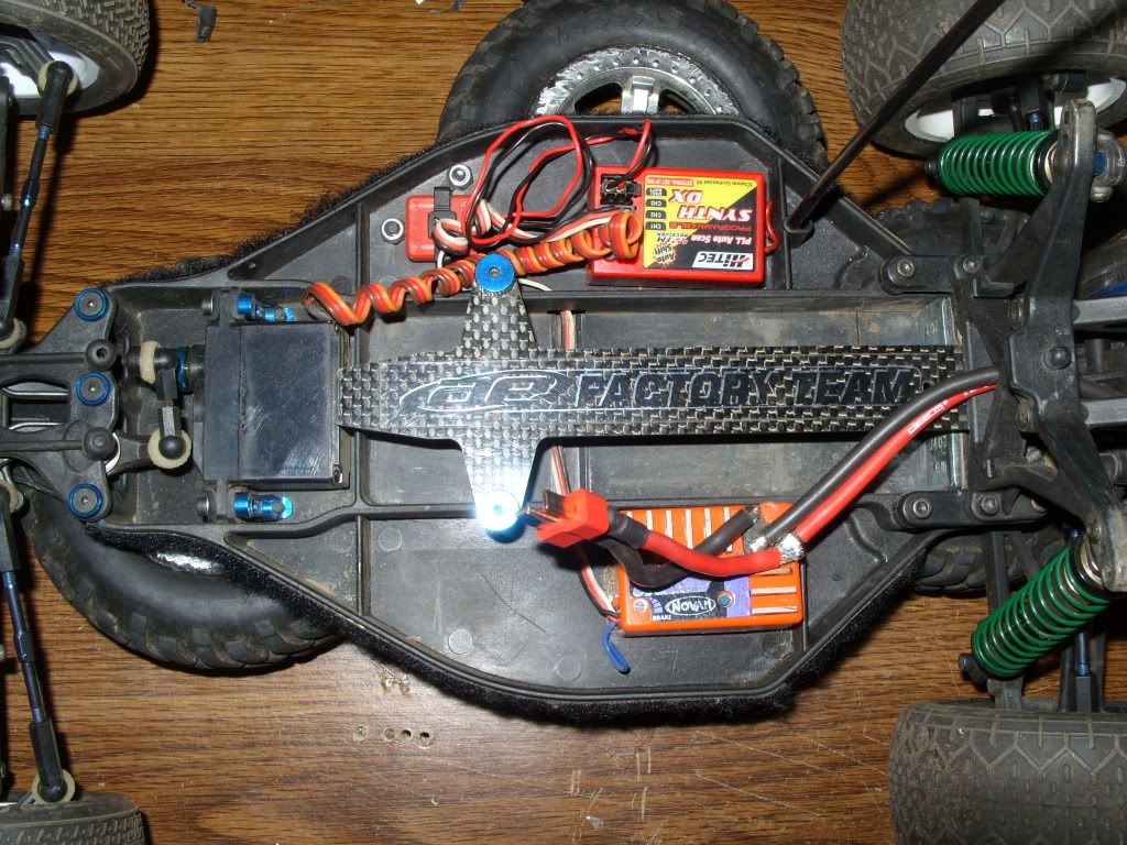

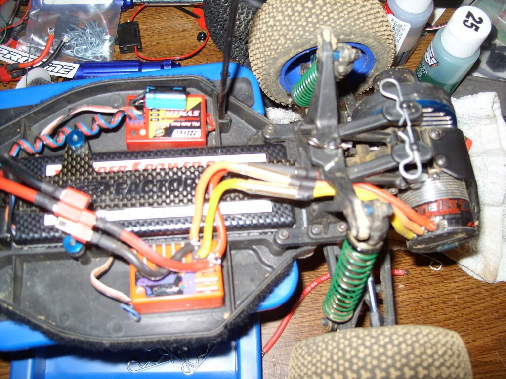

Dropped a Tekin 13.5 into it that I got from a buddy, and as soon as the car was plugged in, it basically went FIZZZZZZZZZZ *smoke*. The motor only had 3 runs on it when it was put into the B4.1 FT in question, and it ran perfect when it was pulled from a buddy's RB5.
Any ideas on what may have happened? Here are before swap and after swap pics. Hopefully you see something I don't.
http://i23.photobucket.com/albums/b3...4/SS851905.jpg
http://i23.photobucket.com/albums/b3...4/SS851946.jpg

Looks like your using a brushed ESC to try and drive the brushless motor.
You need an ESC that's designed for brushless systems.
