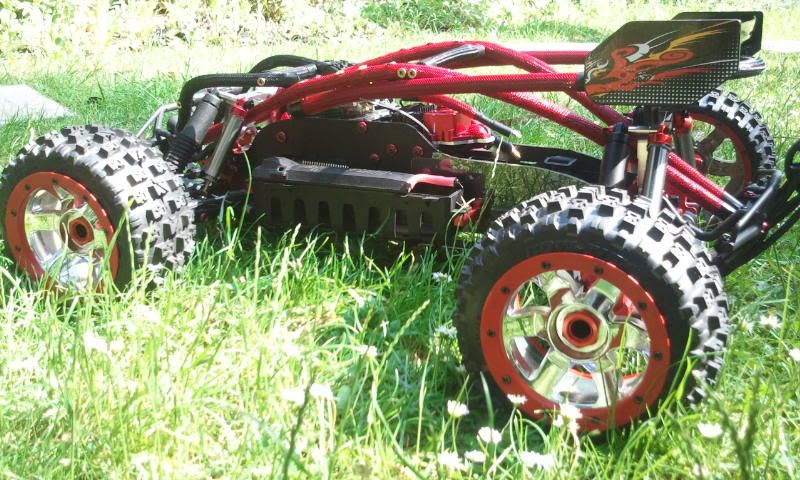

Hope you are all well! I have just got my truck running and my ESC (ICE HV 160) is now behaving weird... I was doing a speed run last night and the truck was pulling harder than ever on 6s, it has been running nicely for the past few days with the ESC performing flawlessly on 6s and 9s and not going above 113 degrees F or 45degreesC As i was running it on 9s yesterday on some 5000mah nanotech lipos 45/90c, i was building the speed of the truck up to around 50mph and then suddenly LOSS of power... I ran to the truck thinking something would go BOOM, but everything was fine... The ESC was normal temps, motor was normal temps around 120F... I unplugged the lipos, and plugged them back in... But nothing. So i tried plugging 6s worth of lipos in. The ESC turned on! started beeping and then after all the beeps had completed, it TURNED OFF? I then tried it on 3s and the ESC turned on, did the beeps, and then i drove it very slowly around, and it seemed fine... ALL of a sudden, it turned off, and then turned it self back on... did the beeps, and then turned off... Basically it isnt staying on? Very funny... I havent had time to had a closer look, but is there anything i should look out for??? THANKS A LOT CASTLE!!!! PLEASE HELP ME GET THIS TRUCK RUNNING AGAIN! for your reference the ESC has only been used 8 times MAX and not even full runs as my pinions keep on snapping haha Thanks http://i878.photobucket.com/albums/a...6-04154347.jpg http://i878.photobucket.com/albums/a...6-04154443.jpg |
