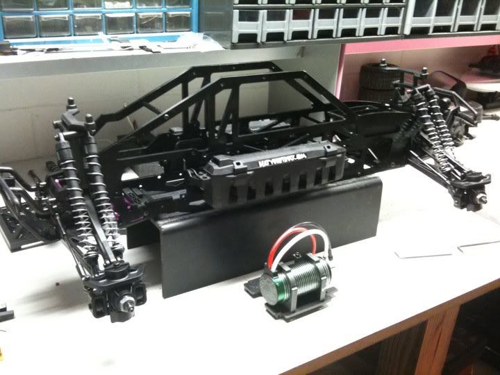

First some questions.
I want to run a 1717. I've been reading up about the Alza mounts for them. What do you guys think about using these mounts with the TCS TVPs? Will I have to do a lot of hacking on the TVPs? I plan to run a Mamba XL on 6S with the 1717. I have a 1520 right now but bigger is better right? :lol:

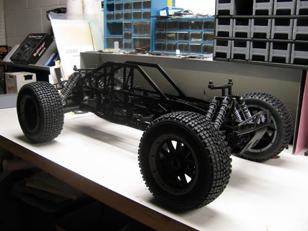

Got a Savage roller a week or so ago with the TCS plates already. It's basically just a Savage 25. I'm not upgrading anything yet. I'll break stuff first. haha
http://i736.photobucket.com/albums/x...r/IMG_3560.jpg

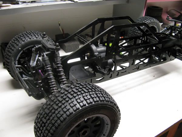

As of last night I had the battery boxes on and have a flux trans ready to drop in (with plastic spur). I also have the motor mounts hogged out for the 1520. Like I said, still thinking about just going to the 1717 depending on what you guys think.

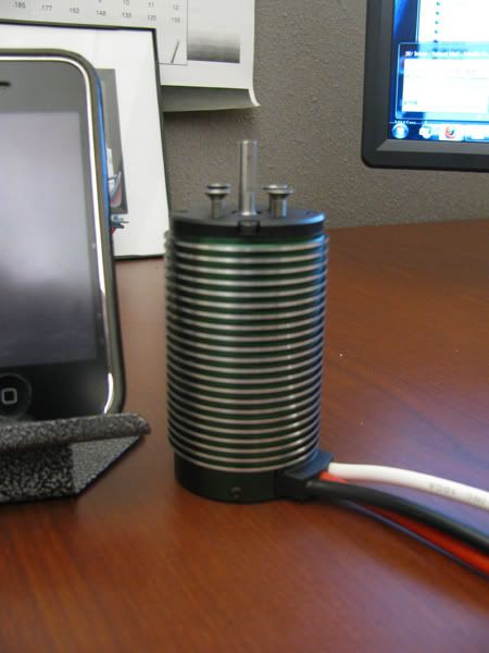

This showed up yesterday.
http://i736.photobucket.com/albums/x...C/DSC_0015.jpg
Easier to pull all the parts I need and part out the rest than buying the parts individually. Heck the body alone is $210 and not in stock....

Yes you will. I'm not even sure that the 1717 will fit length-wise with the TCS TVPs. The 1520 should be able to be mounted with a bit of grinding for to account for the length over the motor over the stock.
You can always grind out the Flux mounts to fit either the 1520 or 1717. I've got the GCM mounts for a 1520 as I was planning on mounting this up, but ended up putting it in my truggy.

The 1717 is actually shorter than the 1520 according to Castle's site. Not by much, 3/16" or so. I already ground the mounts for the 1520, you can see it sitting in the second picture in the OP. I'm just thinking about going to the 1717 now instead of spending time on the 1520.
thzero 06.21.2011 04:15 PM
I would just grind the mounts for the 1717 then.
NickRummy 06.21.2011 04:31 PM
Is there even enough room? I took off quite a bit for the 1520 and the 1717 is a lot larger in diameter.
How do you like the 1520 in your setup? Isn't that what you're running? What all did you have to mod on your TVPs to do it?
thzero 06.21.2011 04:40 PM
1 Attachment(s)
Actually I ran the 1800kv in the 5T as I put the 1600kv in my truggy. I was running the 1800 on 6S, thought it ran cooler than the standard 2200kv. I basically had to grind out the rear of the motor cutout area of the TVP (see attachment, the area where the red circle is).

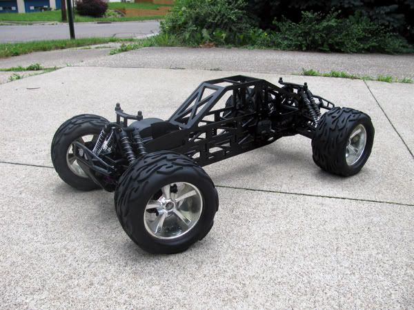

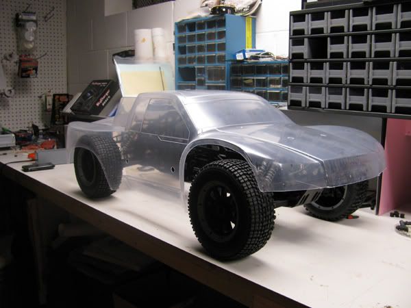

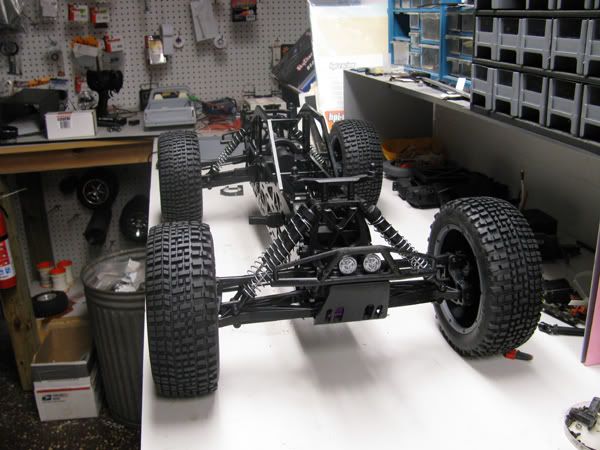

Ok photo time. 5SC wheels and tires are mounted up on stock savage axles with the hpi 24mm adapters. Front track width is 16.25" and the rear is 16.75". It's not THAT far off really.
http://i736.photobucket.com/albums/x...r/IMG_3642.jpg
Flux tranny mounted with the motor plate in. Going to start drawing the 1717 clamps today. Pretty much just going to copy the Alza mounts.
http://i736.photobucket.com/albums/x...r/IMG_3643.jpg

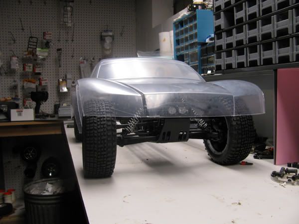

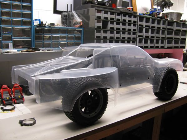

I couldn't help but throw the 5SC body on it......
http://i736.photobucket.com/albums/x...r/IMG_3646.jpg

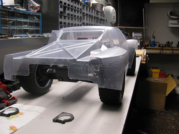

http://i736.photobucket.com/albums/x...r/IMG_3647.jpg
http://i736.photobucket.com/albums/x...r/IMG_3645.jpg
http://i736.photobucket.com/albums/x...r/IMG_3648.jpg
I'm picking up the 1717 today at lunch and I'm hoping I'll have time to assemble the side rails from the 5SC kit so I can see how they'll attach to the TCS plates.
