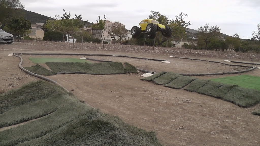

1/5tt marder-monster electric/brushless
1/5tt fg marder + monster tires (21cmx13cm) + castle neu 1717 + xerun 150a + turnigy nano tech 3s 6600mah + homemade conversion kit
runtime ............. 15-18min
temperatures ..... lower 60cº esc/motor
weight rtr ...........9kg
top speed ...........33mph
soon photos/videos :whip:
x-y 07.23.2011 05:51 PM
soon more +fotos/videos :whip:
http://i622.photobucket.com/albums/t...h/S1610025.jpg
http://i622.photobucket.com/albums/t...h/S1600019.jpg
http://i622.photobucket.com/albums/t...h/S1570009.jpg
SV6000 07.24.2011 08:44 AM
The conversion looks good, am currently converting my comp baka 4wd. Am using a leopard 5692 on 8-12s. Am havin the motor mount milled out at the moment.
aqwut 07.24.2011 10:34 AM
Looks good dude, but you may need a much stronger mount doing those jumps... Good Job..
x-y 07.25.2011 07:54 AM
thanks ..... the motor mount is umbreakable ...... steel 2.5mm ;)
