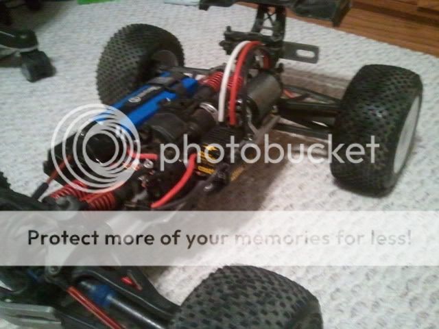

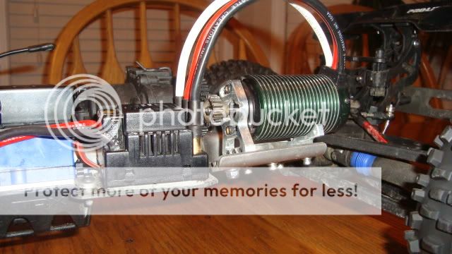

Braden 12.19.2011 01:04 PM
Here are a couple pictures of mine.
Locked in second gear using "Oomps" adapter
Wide ratio second gear
17/40 gearing
rcmonster motor mount
tekno rx box
tekno battery tray
esc mount made from carbon fiber plate
mamba monster 2200kv combo
4s turnigy 25c 5000mah lipos
http://i658.photobucket.com/albums/u...2-15203839.jpg
http://i658.photobucket.com/albums/u...m/DSC00880.jpg
