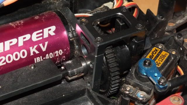

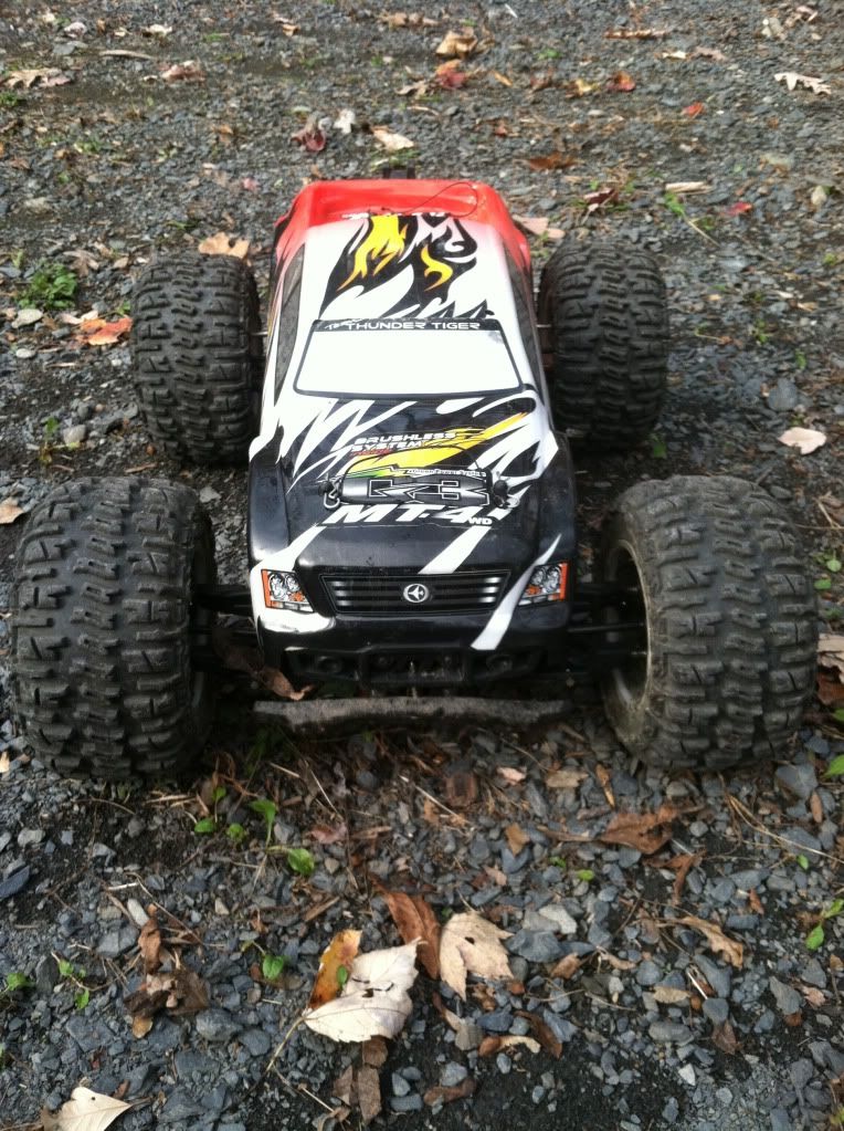

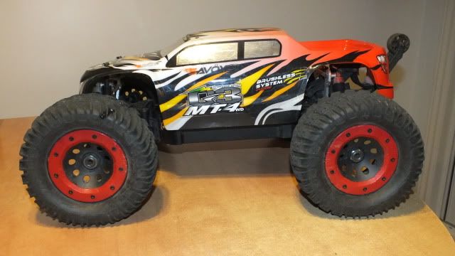

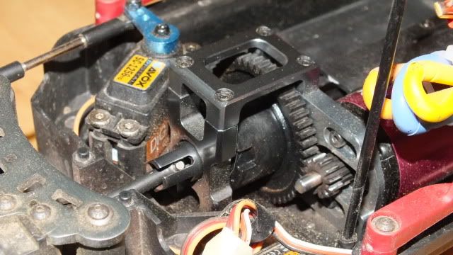

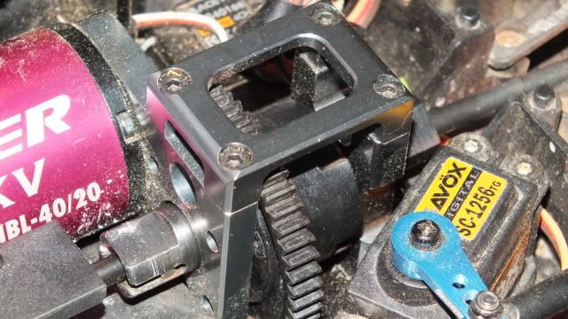

This is my thunder tiger MT-4 G3 picture and video
The option added are : - Aluminium top plate for motor mount - Aluminium diff mount - 3mm rear sway bar - Savox servo 1256TG 270oz of torque - racer edge aluminium servo arm - losi diff lub : 5K front - 7K center - 2K rear - 2x3S flightmaxx 4000mah 40C http://www.youtube.com/watch?v=ni5BOnGQfss http://www.youtube.com/watch?v=eA-se7YwH2M http://i47.photobucket.com/albums/f2...d/MT4G3002.jpg http://i47.photobucket.com/albums/f2...d/MT4G3003.jpg http://i47.photobucket.com/albums/f2...d/MT4G3004.jpg http://i47.photobucket.com/albums/f2...d/MT4G3005.jpg http://i47.photobucket.com/albums/f2...d/MT4G3006.jpg |

It my best truck ever, better than the savage flux, e-revo brushless and e-maxx. Easy to drive at 60mph and easy control in the air. The servo that come with rtr are not good only 140oz, the savox servo have 270oz and it hard to turn the wheel, It think 300oz + are better for this big wheel. I have this truck for 6 month now and never broken part and the tire are the same and i bash this truck on 6S on asphalt, gravel etc...
I have adjust the servo saver and now the steering work perfectly with the Savox 1256TG !

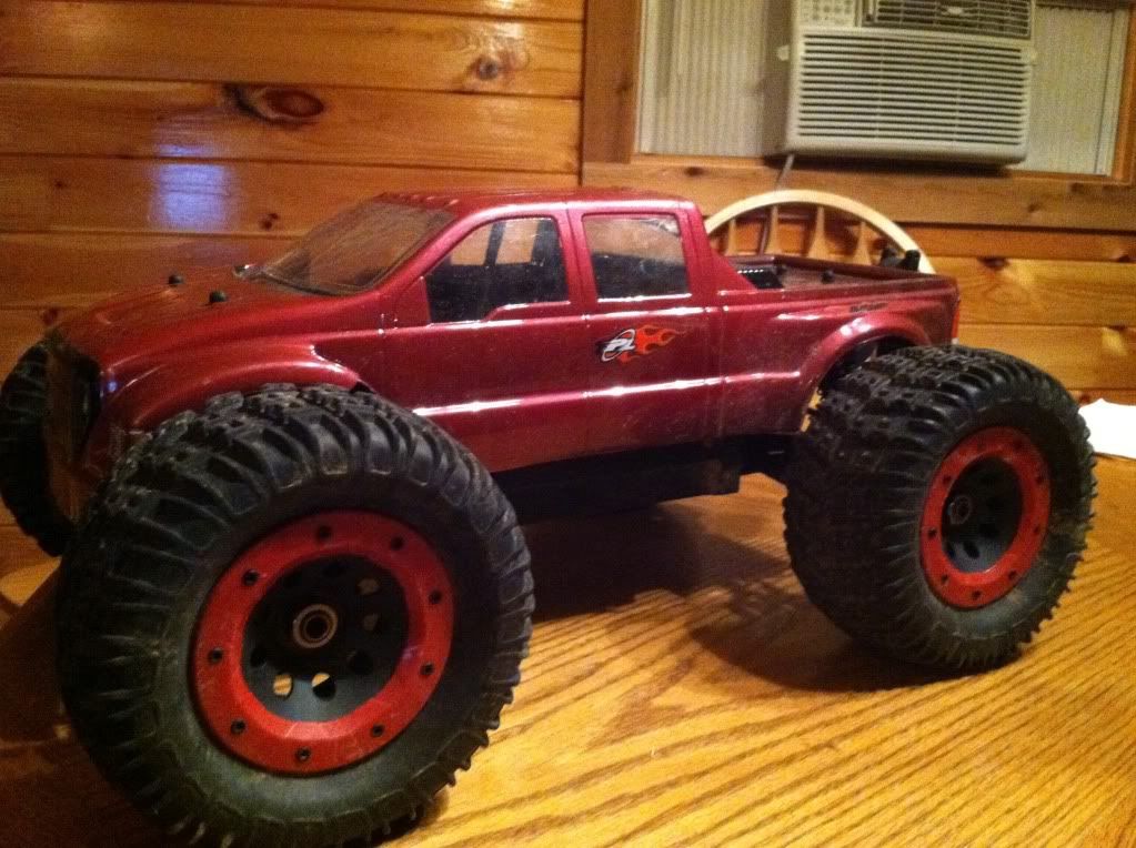

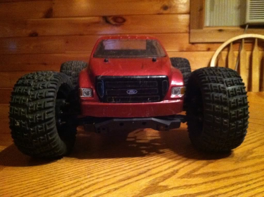

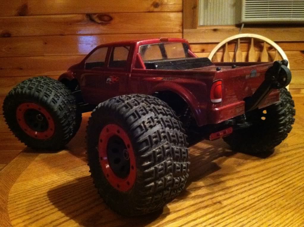

Heres a few pictures of mine. Also my best truck I have had yet. I have beat the snot out of it and it has held up very well. The only real thing I have broken is the toe in block at the front of the rear bulkhead. I replaced it with the optional aluminum block....also replaced all the others for the heck of it.
http://i1208.photobucket.com/albums/...3A21D-orig.jpg http://i1208.photobucket.com/albums/...F2CBC-orig.jpg http://i1208.photobucket.com/albums/...34B9C-orig.jpg |

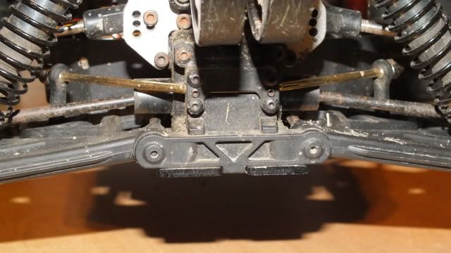

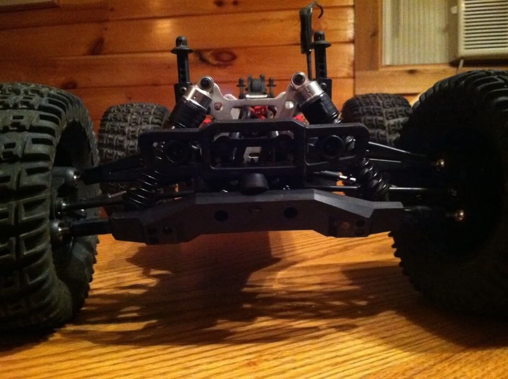

I bolted on this rear summit bumper(upside down) to keep my front lower arms from getting destroyed....I live in a very rocky area. And it also saves the little plastic caps that hold in the loeer hinge pins, I broke both of them and replaced with optional aluminum.
http://i1208.photobucket.com/albums/...2F4A8-orig.jpg http://i1208.photobucket.com/albums/...F58F0-orig.jpg |

Your proline ford F-650 cab are very beautiful Chainsaw10, i think i have find my next cab !
