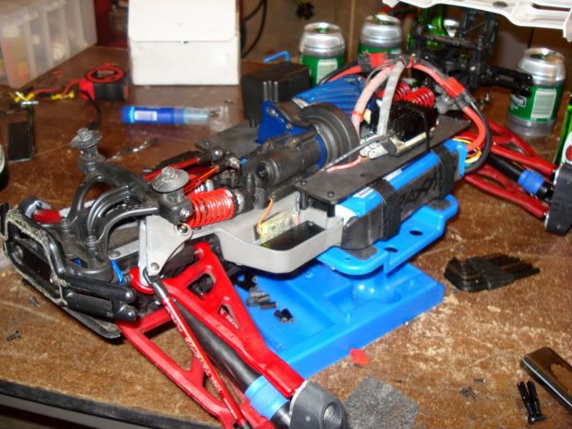

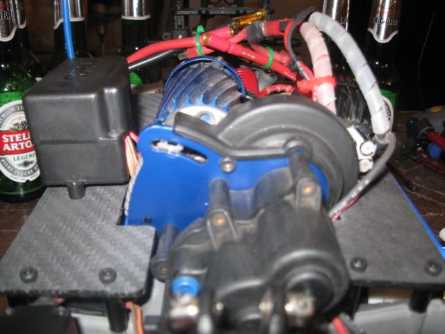

I'm not leaning towards any brand in particular, I loved my pletty in the last revo, and found it to be pretty fast, cost doesnt matter just looking to buy one motor without regrets. Also, making something fit doesnt bother me either, part of my build plan is to make a carbon fiber motor mount, so I can change things up from there.
Last revo: http://i417.photobucket.com/albums/p...o/DSC01261.jpg http://i417.photobucket.com/albums/p...Revo/042-2.jpg |
