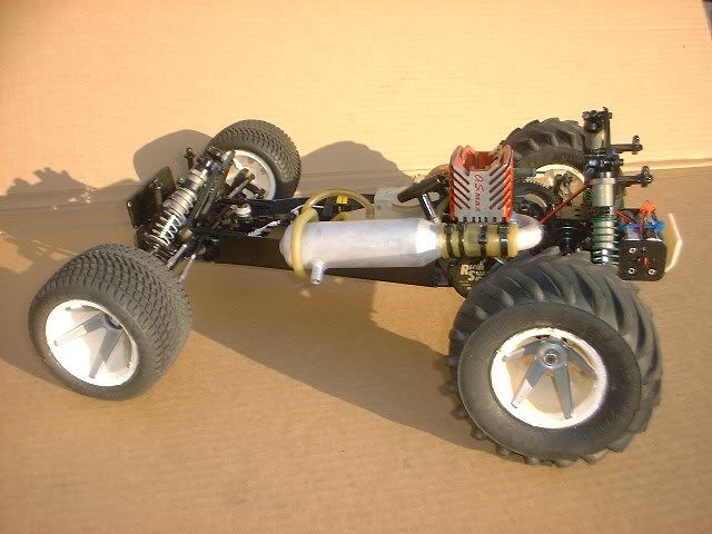

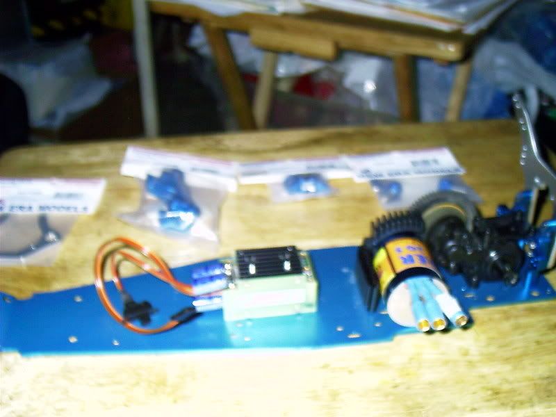

welll i had been planning to convert the rc10gt i won on the bay a while back for $60 bucks into a brushless beast well i've finally started but i broke one of my hex drivers that i needed for the project :d so i have to wait until tommorow and hopefully go pick another one up so that i can get the majority of the work done.... all i need are a new set of rims/tires and wiring to do my esc
http://img.photobucket.com/albums/v4...tSideView2.jpg
what the truck started out as
http://img.photobucket.com/albums/v4...T/IMAG0334.jpg
The trucks new beginnings
here are the specs:
MGM Compro 120 Amp esc
BK Wanderer 12 s
Dual Max Amps 2s 8000 mah lipo's and sometimes a 3s one
New Era Dual deck Chassis
New Era Alu frnt and rear bulks
New Era Frnt C-Hubs and Knuckles
New Era Frnt and Rear Alu Shock towers
Stock Traxxas t-maxx shocks for now
and Masher 2k's will be mounted all aro
und
