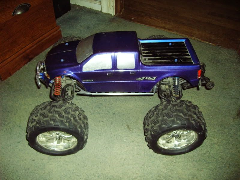

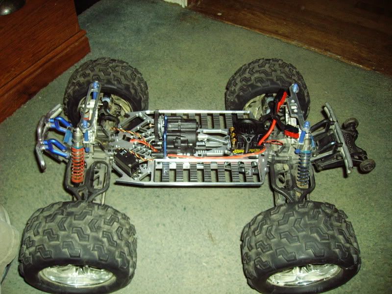

coolhandcountry 01.08.2012 05:49 PM
Took a couple pics today finally
<a href="http://s107.photobucket.com/albums/m284/coolhandcountry/FLM%20Emaxx/?action=view&amp;current=NewFLMEmaxx002.jpg" target="_blank"><img src="http://i107.photobucket.com/albums/m284/coolhandcountry/FLM%20Emaxx/NewFLMEmaxx002.jpg" border="0" alt="Photobucket"></a>
http://i107.photobucket.com/albums/m...LMEmaxx001.jpg
