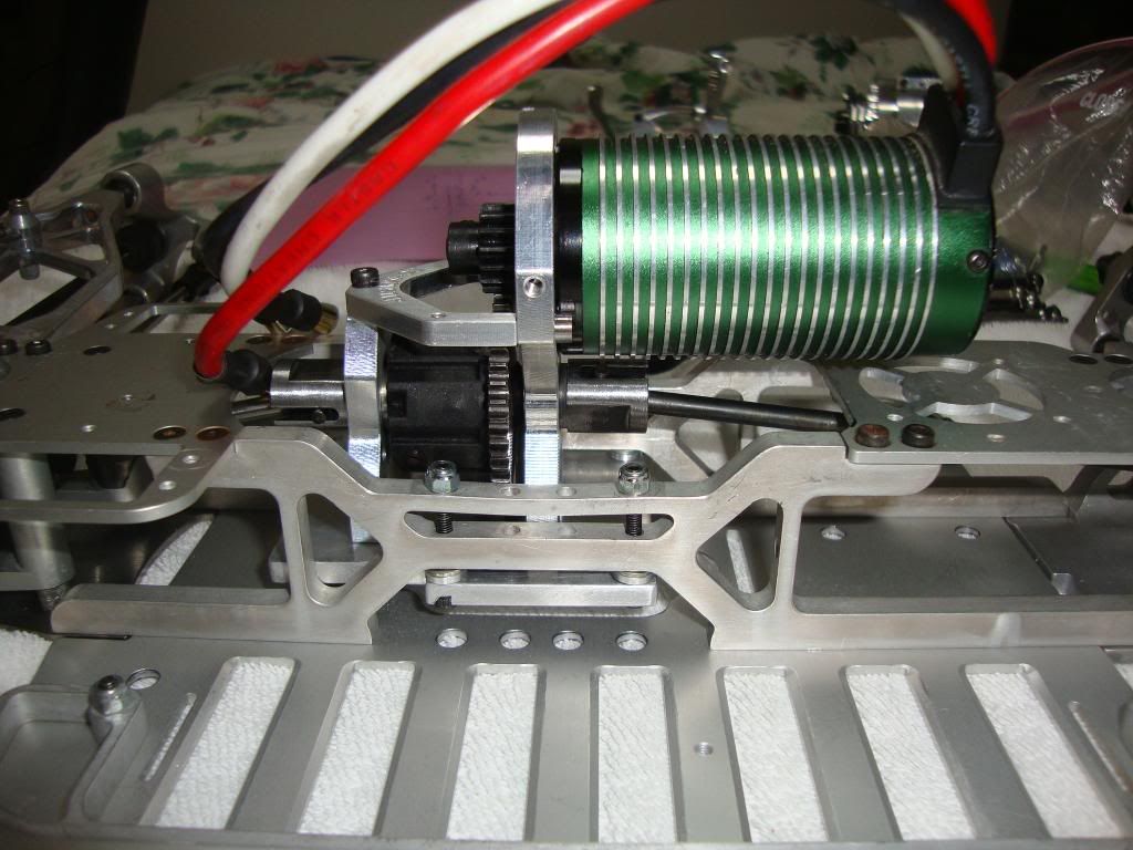

Hi all,
I have collected some nice parts for a new build. I was lucky finding a GorillaMaxx G2 Extended chassis in mint condition and also a RCM center diff/motor mount.
I see others have installed the center diff at the front and I can make it fit there too. However, my UE GenIV servo saver will definitely hit the center diff drive cup.
Question 1:
Will I need to install the center diff in a different location to make room for the steering?
Question 2:
I have a feeling I will need some custom length center drive shafts for this truck. Any suggestions on who to contact for custom center drive shafts?
https://lh4.googleusercontent.com/-n...0/IMG_1268.jpg
https://lh4.googleusercontent.com/-f...0/IMG_1269.jpg
https://lh4.googleusercontent.com/-u...0/IMG_1270.jpg
https://lh5.googleusercontent.com/-Z...0/IMG_1272.jpg
https://lh4.googleusercontent.com/-I...826_161804.jpg
https://lh3.googleusercontent.com/-S...826_161841.jpg

Klausen 08.26.2012 01:33 PM
Hey G
1: Probably move it a bit back. Maybe pm Bosox, I don't know if he had his with a gen4 saver, but the centerdiff definately is up front.
2: I think Mike makes custom driveshafts.

gumleguf 09.06.2012 01:41 AM
Considering different mounting options. What do you think; motor turning forward or backward?:
https://lh3.googleusercontent.com/-f...905_193913.jpg
https://lh4.googleusercontent.com/-0...905_194014.jpg
emaxxthemonster 09.07.2012 09:21 PM
Motor forward. Slide it forward a little bit more. Did you think about trying to find a smaller drive cup?
Look around online, maybe you can find some drive shafts already made. Try to find a set before you mount it, so it the closet driveshaft you could find is 1 or 2mm shorter just bring it back or move it forward. Then just find one for the front.

gumleguf 09.21.2012 02:01 PM
Wanted to show the center diff mounting plate I've had made. I wanted it this way so I have different options for mounting it and it can be installed both facing forward and backward. The plan is to install it facing forward as it is now. The rear dog bone is the one from the FLM10900.
