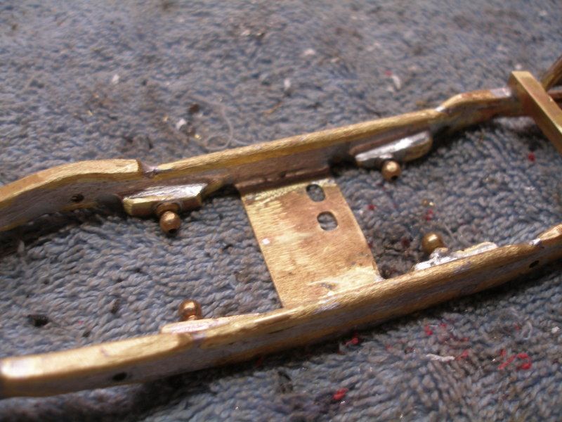

I'm not going to type every step of this build so if you have any questions please feel free to inquire.
The skinny;
One off custom scaler chassis 5.5" WB
1/20 scale 96 Jeep Grand Cherokee (Highly modified)
Losi Trekker axles, trans, drive shafts
HR alum beadlocks with cut Boggers and Delrin BL rings
Castle Mamba Micro Pro/decased
Hitec HS85MG servo (50oz of torque)
Spektrum RS300

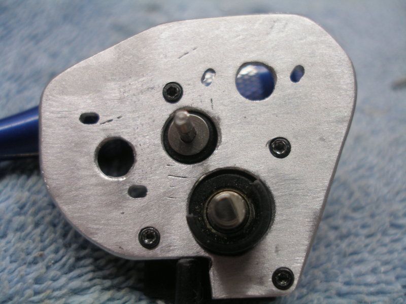

Custom made motor plate to run Dual stock Trekker motors
HR shocks
300mah 2s lipos
LEDs

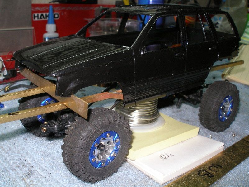

I did of LOT of styrene work on the body, I hope the following pics do some sort of justice for all the time invested.
