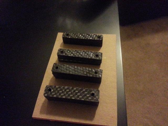

Big House 06.19.2014 10:51 PM
Lowered Carbon LST 2
3 Attachment(s)
I needed a way to keep my LST2 from flipping over on the turn so I took a lesson from racing and lowered the COG. I took some scrap carbon and built, for all intents and purposes, drop blocks and raised the front and rear mounts 12mm or so. In the DMV area so, the first dry day, I plan to see how much better it runs.
