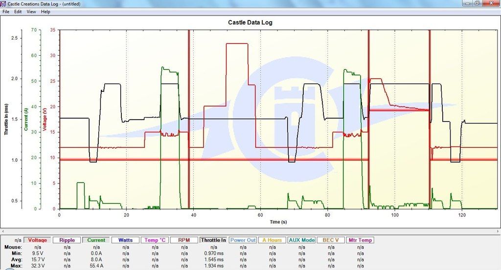

Slightly off-topic here, but the new MMX might have some Voltage overhead, Lizard's MMX factory bench log on it showed it was tested up to 32V input; that was without throttle though (see below). My MMX FAT logs were just ~6S, so not sure what's the deal there. Does anyone happen to know the FET rating of the MMX?
I've heard people running the 1/10 Sidewinders on 4S too, which seemed to work if a UBEC was used. Would be nice if MMX could be run on 7S without too much added risk.
