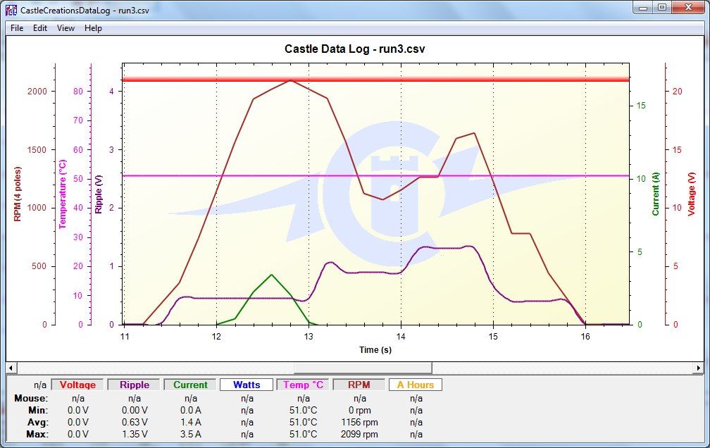

Suddenly, the car wouldn't accelerate anymore, only cogging/rattling noise.
Checked again when at home, after power-up there is no beeping anymore, when throttling it just coggs and doesn't move. Also tested with a different motor, the same. BEC, LEDs and Castle Link connectivity work fine though, looks like there is something broken on the power stage and the control board is still okay (?)

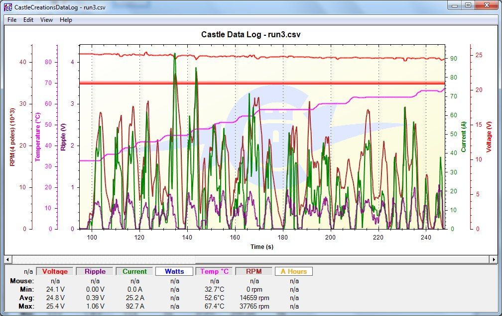

Datalogs show maximum currents of around 90A, average currents around 25A, ripple around 1V, nothing too high in my opinion. Although my Mamba Monster Extremes don't have data logging, I'm pretty sure I have run much higher peak and average currents through them with the 1717s and the TP4070 and TP5840S I have.

Datalog zoomed in after the defect happened, when trying to give throttle:
http://i54.photobucket.com/albums/g1...ogging-log.jpg

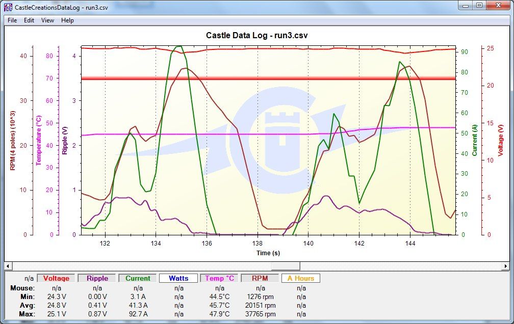

Datalog zoomed in of highest peaks during last run:
http://i54.photobucket.com/albums/g1...t-peakslog.jpg
Complete datalog of last run:
http://i54.photobucket.com/albums/g1...6/run3-log.jpg
