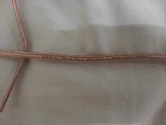

Silentenigma 11.19.2018 11:51 AM
1 Attachment(s)
I think it's Fig 8 cable.
ruudxd 11.19.2018 03:39 PM
I would not do that, Maybe if you dubble it up, so two to three lengths per pole.
Personally I would use 10 gauge or bigger.
Which awg is on the charger?
Silentenigma 11.19.2018 11:52 PM
There using 14 gauge for the input leads/aligator clips.
ruudxd 11.24.2018 05:08 PM
Ok, but longer cables equal more losses.
I would double the wire up to try, but keep an eye on the temps!
