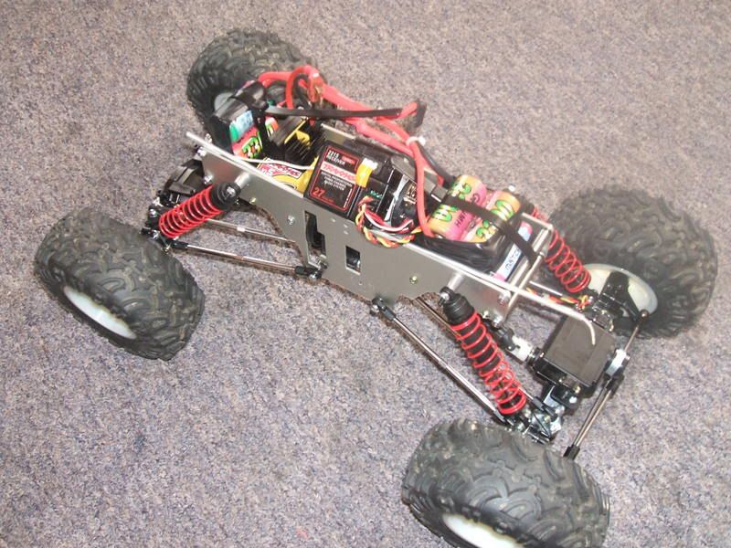

WEll, after receiving my TLT yesterday this is where it started at & ended at....
this is what it 1s comprised of:
Integy Pro lathe 55t motor
Traxxas XL-5 ESC
Hitec 645MG servo
Proline Moabs, mounted on rustler front rims
Emaxx shocks (4)
Traxxas turnbuckles ((4-96mm/ 4-108mm)
Stampede tranny locked & geared 13t pinion/87t spur
7 cell GP 3300 NIMH ( aranged in 5 cell & 2 cell config for weight reasons)

Aw.......it's so cute.....makes me wanna finish building my TLT. Any other plans for it? I would triangulate the upper links some more so you don't have the axles wander, use a stock TLT link and make an alum. plate that goes where the stock servo mount is (make the new mount for the servo too), then bend up the back and install one of the stock single hole brackets as the upper link mount. If it's confusing I guess I could take pics of mine....
