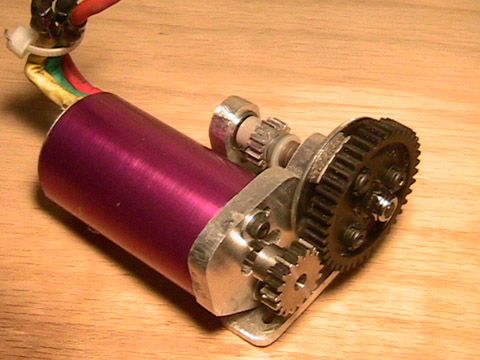

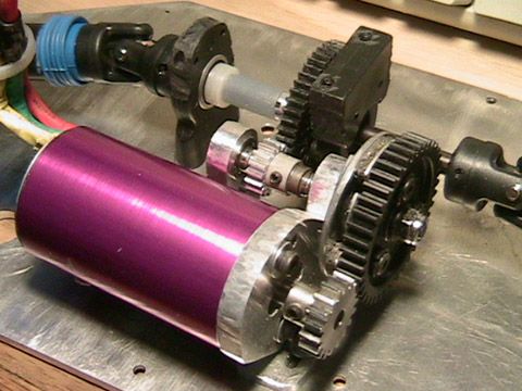

For a while I had been working on a custom monster truck project using Maxx diffs. I was working with a custom center transmission consisting of just a shaft with an integrated slipper clutch/spur gear mount. The problem I ran into is that I wouldn't have been able to gear properly because of the relatively low gear ratio of the Maxx diffs (2.846:1). I did make a special gear/motor mount that utilized a total of 4 gears (including motor pinion gear) that had a built in Revo slipper clutch. This made it possible to get the perfect ratio without using gigantic spur gears and microscopic pinions.

Just for reference, I have some pics of the "gear reduction unit" that I made:

The drawback for this is rotating mass, more general weight, and more friction. I think it might be a good alternative to an E-Maxx transmission, without the 2-speed.

Interesting unit! It si basicaly like a single speed e-maxx tranny laid on its side. I guess you would have to mount the batteries opposite the motor?
MetalMan 05.23.2005 10:41 PM
That was the idea. That chassis that it is mounted on was just an old one. I made a newer chassis since then, but this project was discontinued due to the difficulty of getting it together. Really all I needed were specialized bulkheads that could mount the arms that I specially designed. Even though the project died, I still have ideas from it, and they may come in handy later on.

Metal Man, your thing looks well made. I, too, ran into the same calculations.
