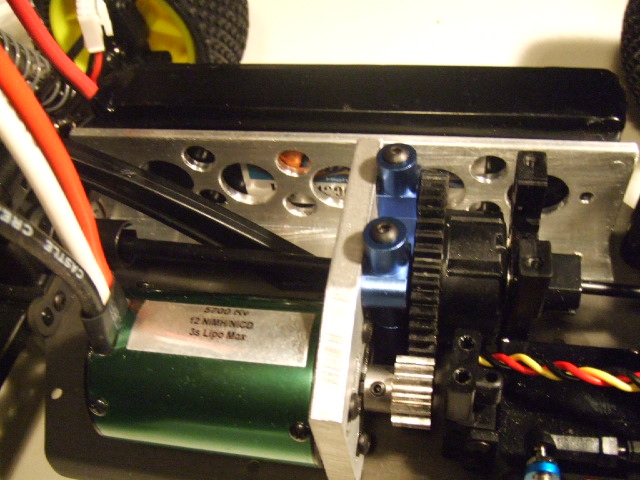

IBJAMMIN 05.14.2007 08:12 PM
1 Attachment(s)
Originally Posted by E-MAXX Rock's
jammin, i will cut the servo ears off and stick it on, so u still think theres not enuff room in there?
i dont want to ext it, because then it isnt as small, which is tthe whole point of this lil guy, but thx!
You know what I just took a closer look and a full size servo will hit the center diff if you move it over to clear your steering arm is going to be past the chassis line:002: looking at the BCE chassis he extended it from the center diff forward to get more room for the full size servo. you can see how close the mini servo is to the diff in the pic. I also dont like the idea of sticking the servo down on a 4lb 4wd truck it's ok for lighter cars like 10th scale buggys and 2wd trucks.
The diff's are holding up great I removed mine and filled them they were not full from the factory.:( You dont have to go to heavy on the diff oil to get it to wheelie I tried 10000wt and with the 5700 MM and 3s lipo there no problem. I have Jammin Jays set up in mine also and it worked great at the track. :)
