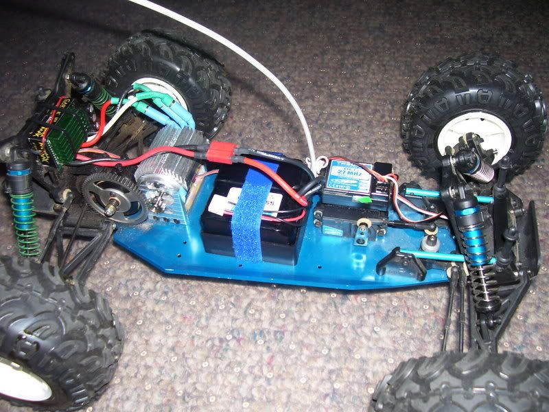

I just got my RC10GT back from Mike. He installed the esc, made the motor mount, made the battery box and supplied all of the parts.
Here are the before and after pics.
http://i142.photobucket.com/albums/r...C/100_1350.jpg
http://i142.photobucket.com/albums/r...C/100_1698.jpg
Link for the rest of the pics http://s142.photobucket.com/albums/r118/nastety92/RC/
I'm running a MM esc,
7S motor with RC-Monster heatsink
MaxAmps 5500mah Saddle Pack
I have a new steering steering servo that is not installed yet and the the receiver mount is temporary.
The problem I'm having at this time is the esc will not program to the receiver. When I go through the setup nothing happens. I turn the esc on, the red and green lights stay on and it only beeps as soon as I turn it on, nothing happens after?? Any idea what I might be doing wrong? All help would be greatly appreciated. While the truck was at RC-Monster Mike tested the truck with his own receiver if that makes any difference.
Also I would love to hear everyone comments about how the truck came out. I think Mike did a great job, I love the way it came out, cant wait to drive it now.

Can't really help you with the programming of the MM... but the rc10gt looks awesome. As always Mike does an awesome job on these conversions. Glad to see another converted st. You don't get to see these very much.

Looks like he maybe used a modified Revo mount on there to mount the motor. I bet that saved him a ton of time in the fabrication. At any rate, it looks great and be sure and let us know how it runs...preferrably with some vids! :D
