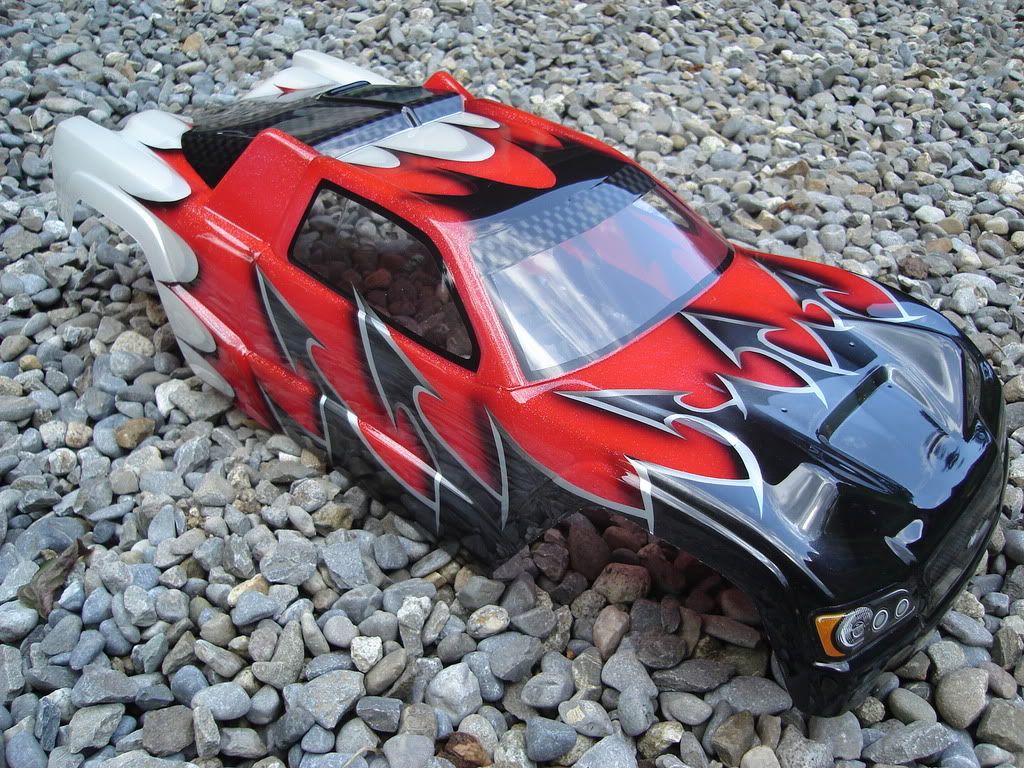

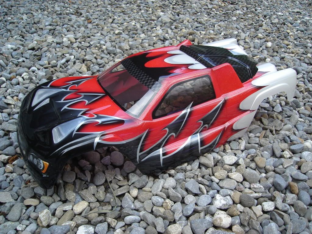

Maybe one of you Hellfire guys would be interested in a body I painted?
It's a HPI Hellfire Body (7198 DRX), note the lack of nitro holes, perfect for BL conversions :)
http://i201.photobucket.com/albums/a...t/mai07010.jpg
http://i201.photobucket.com/albums/a...t/mai07014.jpg
PM me if interested. Any other special requests welcome!
Cheers
DAF
Serum 06.03.2007 07:41 AM
it's a beauty Daf..
