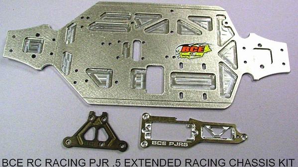

The problem with trying to fit full size servos is not mounting it? it's the fact they are just to big depth wise by the time you clear the center diff the servo arm is hanging over the chassis line a 1/4-3/8 of an inch. I think BCE is working on a longer wheelbase chassis that can run full size servo's though.

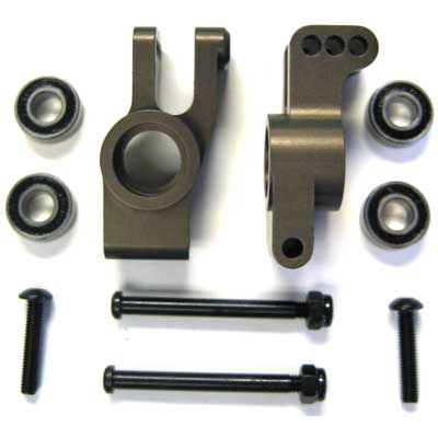

Futaba makes a full size low profile servo S9550 that is looking very interesting if I have anymore servo problems that will be my next choice.:032: The diff's in the CRT.5 are 1/8th scale size and metal in a 1/12th scale car they are holding up great no sign of problems yet I would recomend opening them up and filling them they were a little skimpy with the fluid from the factory. :017: I like the new high downforce wing for the CRT.5.:004: here's what you get with the CNC rear hubs new bearings and hinge pin with locknut's. The part's keep coming out from Jammin http://www.nitrohouse.com/options_jammin_crt_05.htm They added CNC diff mounts and diff pins. I must say Ofna and Jammin finally got it right the CRT.5 has been suported with part's avalibility from the time of releasing the kit and the kits are in stock at most retailers. now the full release of hop up part's.:005: |

The chassis kit is $98.00 & is only 3mm longer just enough to fit a standerd servo in the steering area but you still have to use a mini servo in throttle if running nitro. |
