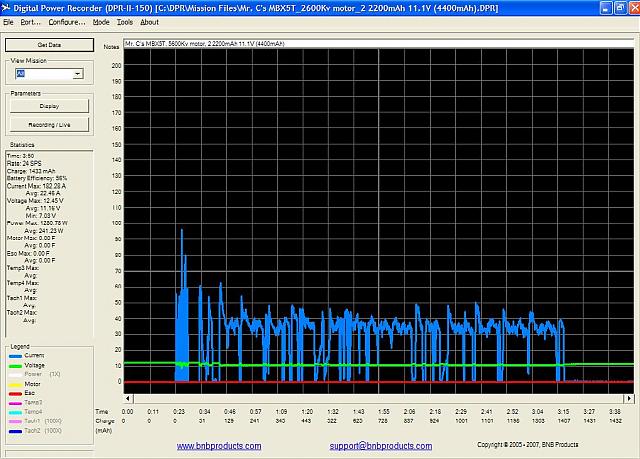

Yesterday I ran the Traxxas VXL-3S and the results were not good. My set up is:
Mr.C's MBX5T electric conversion
Airtronics MX-3
Airtronics 92836 receiver
Rx pack
Hitec HS-945MG servo
2 2200mAh 11.1V (Parallel 4400mAh testing this while waiting for the 5000mAh packs)
3656 size motor 2600kV
51T spur
15T pinion
NOTE: Almost all ESC will have reverse disabled accept the Actronic and the Schulze's.
The VXL-3S didn't seem to start as good as it did while in the air. On the ground, it cogged really bad. I had to give a little push for it to get going. When I got home, I opened the ESC just to see if there was anything wrong. Found one of the MOSFET was at the point of burning. The VXL-3S had a fan installed and it was cool after the 3mins or so before it stopped. Next I will run the MM with the same set up to see if I can get a different result.

Actually the VXL-3S didn't overheat. It just stopped working after 3mins. I just noticed the data from my DPR-II-150 is a bit fuzzy. I will see if I can do something about that for the other controllers. After I test the MM, I will go ahead and try the MGM 16016-3S.

I forgot to mention my truck only weighs about 7 pounds. I ran the M.troniks and the MM before getting the VXL-3S and they ran fine. I thought the VXL-3S would do well since it is rated at 200A continuous and 320A peak. My guess it was only made to work with the light Traxxas vehicles. I drove my friend's Rustler and it was really smooth. Do you guys think the MOD1 gears might have something to do with this? Here in NJ is a bit cloudy, but I'll see if I can get some run time with the MM.

Just came back from running the truck with the MM in it. I was waiting for the data to come up. I have to say that the MM did cog just a bit when I started, but once it got going it ran flawless. It ran cool without a fan and it seemed to be putting out more power then the VXL-3S. The batteries were just warm and when I put them on the charger they read 11.25 volts. I could have ran the truck more, but after 5+ minutes I think it shows how good the MM is compared to the VXL-3S. I will test the MGM 16016-3S later today and post the data here.
