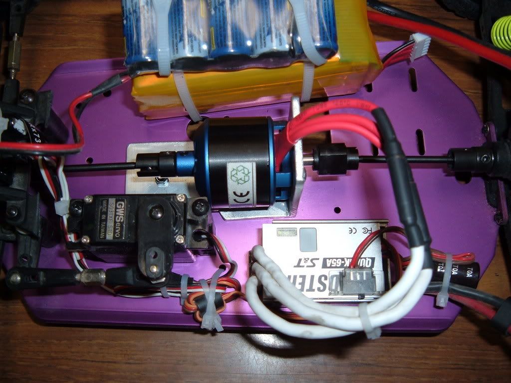

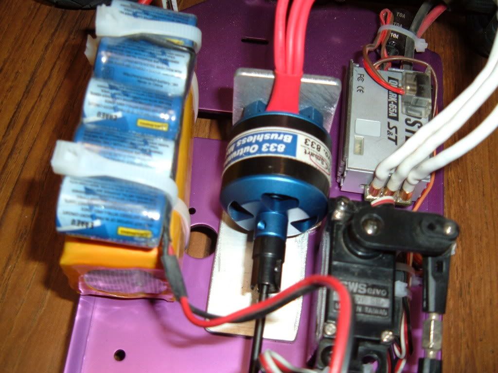

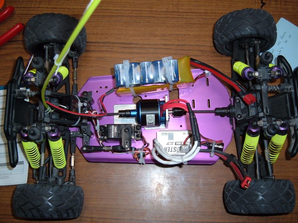

Copied this from the temp forum. Got bored recently and tried 4s lipo. The truck worked alot better, slight cogging from a standstill, but if I was liberal with the throttle it would take off without problems.
Here is a link to the thread: http://www.rc-monster.com/tempforum/...read.php?t=845
Here is the original post:
Hey guys, just finished my mutant redcat/outrunner truck thingy. It runs great, still playing with the quark settings to get zero cogging from a standstill. I almost have it right. Truck runs well, temps after 10mins were 150 motor, 130 esc and 100 battery. I am running a 5s 2200mah 20c battery. Interestingly enough setting the quark for outrunner does not work as well as the std inrunner setting. I have the torque settings all the way up and the neutral set wide, as the maunual suggests that for cogg prevention.
Differential Ratio: 2.75
Transmission Ratio: 1
Other Ratio: 1
Spur Tooth Count: 1
Pinion Tooth Count: 1
Total Voltage: 18.5
Motor KV: 833
Tire Diameter (inches): 3
Tire Ballooning (inches): 0
Motor Current Draw: 0
Motor coil Ω: 0
Spur/Pinion Ratio: 1 : 1
Total Ratio: 2.75 : 1
Tire Circumference (inches): 10.21 inches (259.34mm)
Total Motor Speed: 15410.5 RPM
Vehicle Speed: 54.18 MPH (87.03km/h)
Effective Speed Rate: 2.93mph/V (4.7kmh/V)
Effective KV Value: 833
Motor Torque: Amperage not specified...
Final Torque: Amperage not specified...
Heres the pics, enjoy. Please excuse the zipties
http://i206.photobucket.com/albums/b...p/DSCF1326.jpg
http://i206.photobucket.com/albums/b...p/DSCF1327.jpg
http://i206.photobucket.com/albums/b...p/DSCF1329.jpg

We did a direct to diff conversion on a Kyosho Inferno GT with a Neu 1512 1900kv motor. On 5S with 3.9" GRP Rally tires, we clocked it in excess of 90 mph several times.
What is the kv rating of the motor that you are using there?
lincpimp 09.25.2007 06:29 PM
Motor is a 833kv outrunner, got it cheap off ebay.
Not too familiar with the power output of the various sized outrunners. I would do a lower kv next time, 650kv sounds about right. I would also go bigger, like a 45mm can that is longer, so more torque. This setup has plenty of power, but the truck is very light, so that helps. This is not suited to off road IMO, it works great on road, very smooth with the quark and less drivetrain resistance than with a pinion/spur. Seems to be effecient too, not enough testing yet to be sure though.
MTBikerTim 09.25.2007 07:13 PM
That is nice. It should be really efficient. Less weight and less resistance. A bigger can would help. More power and may be better off road performance (?).

The 46 size 670 kv looks interesting, The lower kv would let me put larger tires back on it and have more torque for startup. Do you think that the quark 65 would be ablee to handle that motor? Plus I would need to step up to better batteries, I have a pair of 20c 5000 2s lipos to run. And my motor mount would have to be remade to accomodate the larger can size. I will see about finding one of these motors and change up my setup.
pcnutz 09.25.2007 10:28 PM
if that is a 4 pole out runner, see if your esc has 30 degree timming, that should fix your cogging issue
lincpimp 09.25.2007 10:42 PM
Not sure if the quark has that kind of adjustability, I will check.
Probably need to do the heatsink mod the the 65 as it appears to be comming of the thermal tape. Any reason why I can't delete the case entirely and just epaoxy a heatsink to the fets and maybe put it in a little box like the MM? Or maybe shrink it like a bk esc?

Yeah, my setup with the 46 on 4s lipo would be around 40mph. My only issue would be lack of a slipper for an off road vehicle, and you would need a good slolid motor mount, like 1/4" 7075 al. I was also thinking that i could incorporate two revo slippers, one on each end of the motor. a custom shaft and adapters to replace the spurs with drive cups would be required. Might add too much length though. If you really want one, I may be able to get a discount, not sure how much but give me the #s you want and I can ask my buddy. Looks like the 46 would be about 80-85 bucks from him.
