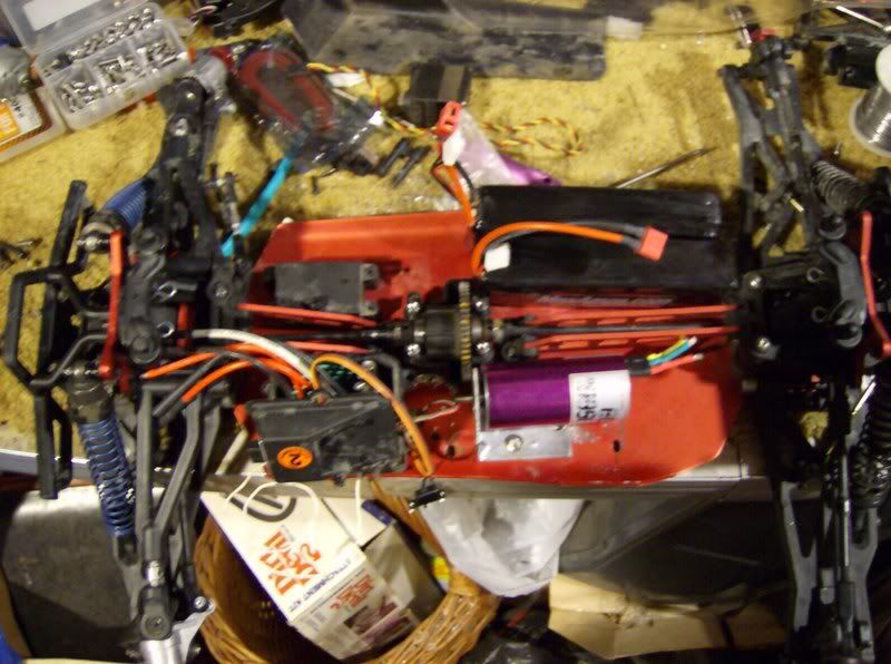

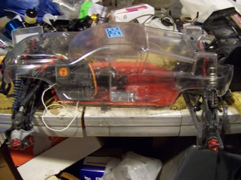

Thunderbruiser 10.12.2007 01:01 AM
couple pics of the conversion progress so far...
http://img.photobucket.com/albums/v4...Project003.jpg
http://img.photobucket.com/albums/v4...Project001.jpg
old pl cp 2.0 for st-r was gonna be mounted on something else will be used on this for now...

hey arctik you think that would help in my quest to run a 5s setup on the 10xl it's gonna be a 2s 8000mah and a 3s 8000mah ran through a y harness
Thunderbruiser 04.08.2008 03:40 PM
hey guys i am thinking of putting the motor over the center diff...what are your suggestions on this?
Thunderbruiser 04.08.2008 03:41 PM
cause i want to run a pack on each side of the chassis...
