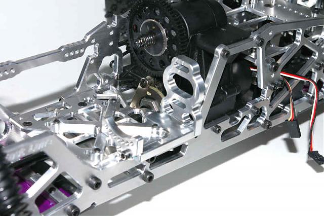

Guys,
I have seem a pic here and there on this forum, but Mike didn't post the nude pics.
What we have here is a new right side chassis and the new FLM motor mount.
Fast Lane 11.28.2007 01:17 AM
We are actually in process right now machining a new version of the TVP with the tranny moved 1.500" foward to allow more room for batteries, and to aid in weight distribution.

I know that your still designing them but what tvp style's are they likely to work with, Extended Low Center of Gravity TVP ,Low Center of Gravity TVP etc.

Does that steering servo mount provide bracing for the top of the steering tubes , i.e. where the old radio tray used to brace it?

My concern is the clearance for the dual brake setup.

Fast Lane 11.29.2007 11:09 AM
For the steering servo mount: yes there will still be a brace that connects the steering tubes to the tvps.
Right now the forward tranny tvp will be based off the Ext LCG TVP. I am sure we will offer one for the non ext. But I will like to first see how things go with this one.
We designed the pictured tvp the way we did to keep cost low. For one if you had or ext tvps you would only need the one side and mount. But due to battery issues we proceeded to the forward tranny tvp.
