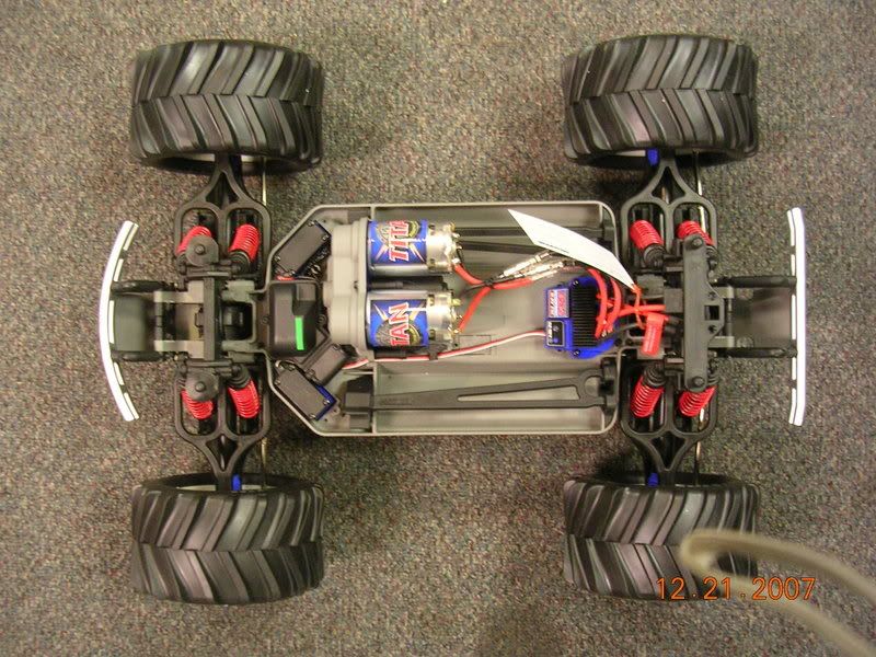

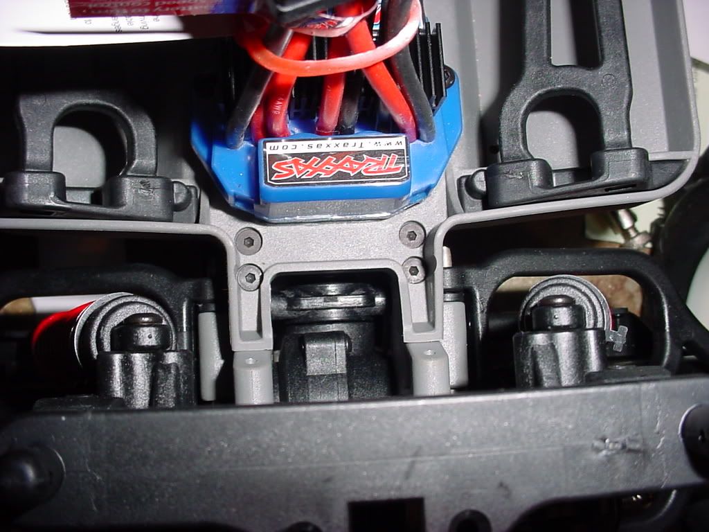

How is the bulk chassis junction? It was supposed to have been strengthened. What does it look like? |
looks good, my lhs said they should have them on monday.

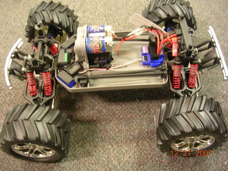

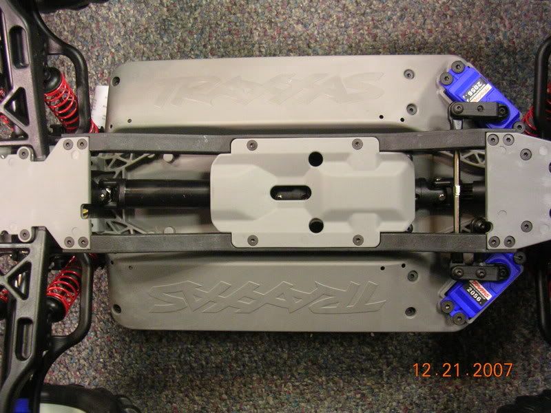

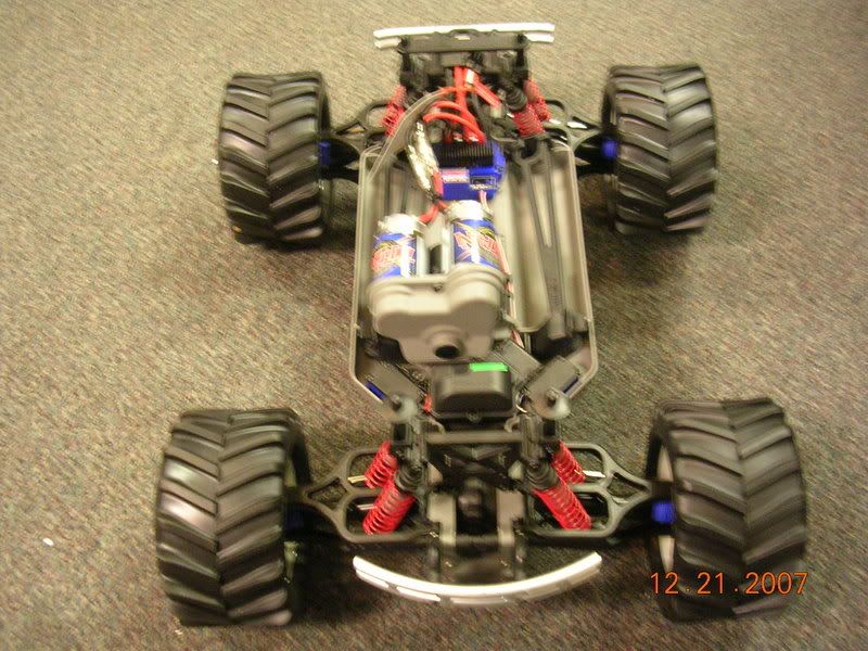

It really looks to me like this chassis would hook right up to an older E maxx front and rear.
I haven't tried it yet, so there might be something different. http://i160.photobucket.com/albums/t...m/DSC06710.jpg http://i160.photobucket.com/albums/t...m/DSC06709.jpg |
Nice man! Not that Im worried anymore since I love my new Gmaxx motor mount (old version), but can you get some measurements of the tranny mounts- I wonder how different the mounting pattern is. By all accounts though, the chassis and braces should bolt up perfectly to an older style Emaxx, as should the steering mech (so long as its 3.3spec).
