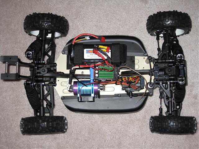

1 Attachment(s)
Just a quick pick right now in case your curious.
