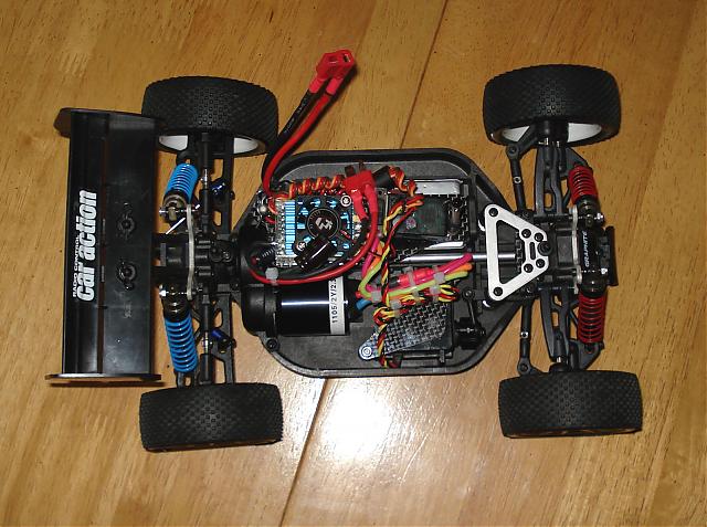

Vendettas can hold up to brushless just fine. All you need are cvd's and one ball diff for the rear. You can get away with gear diffs if your motor is mild. Everything else beyond that should be tuning upgrades like better turnbuckles, tires, etc... but not needed if you plan to only bash it.
these are how my detta's are currently set-up.
