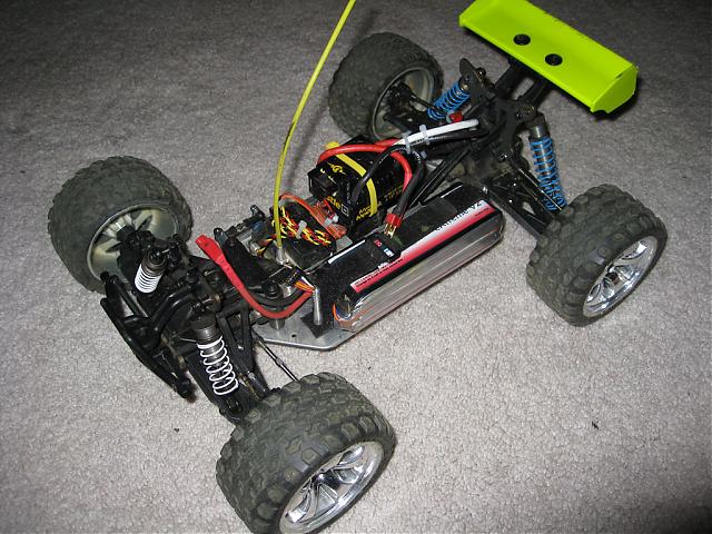

Just sharing - I'm trying to keep myself to 2 buggies rather than trying to keep up a fleet this summer and just end up selling off rollers once I start to get a little bored with them.
Not an easy task as I still want to get a ST-RR, XT8, E-Revo (when available), a 1/8 1/7 or 1/5 on-road and maybe a LS10 or DBX.
Anyway - sticking to make the CRT.5 more and more fun to drive and much more efficient at the same time.
Latest upgrade include a Neu 1509 2Y (1820 kv) with MMM and TP eXtreme V2 5S 3850 lipo pack. Geared 15/46 with 4.1" Proline 30 series rims (about 40mph and expecting avg. Amp peaks to be around 20 - 25 Amps).
Yes I know the MMM is way overkill here, but I may want to test the setup with 6S for a little bit. Once I am sure 5S is the ticket I'll throw a fan-cooled MM so I have the MMM back for whatever I won't be able to resist for the next project.
