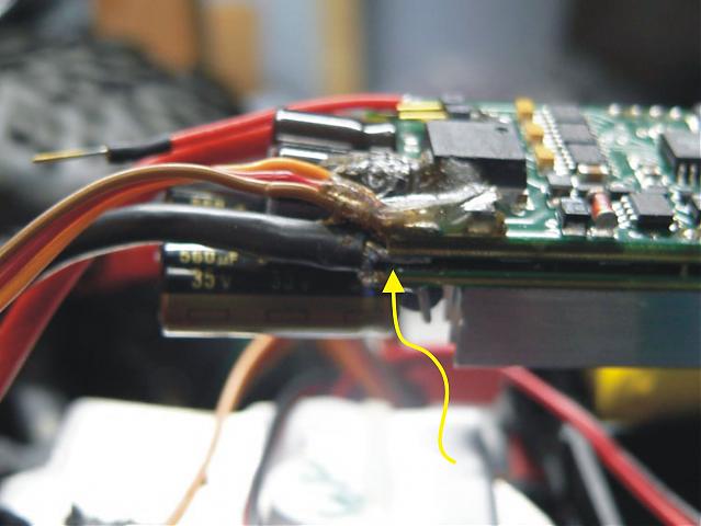

Why you do that?, but you have done that...
It would be hard and as you noticed it doesn't stay there, so no.
Try to solder to black power wire which is on opposite side of ESC, but do not try solder to pcb unless you confident with your soldering skills. I would recommend to strip wire and solder far from ESC and heatshrink or tape it.
took the shrink wrap off because I thought I was going to have to solder it back on...already wishing I didn't take it off
So should I solder it to where the black wire is soldered to the esc?
