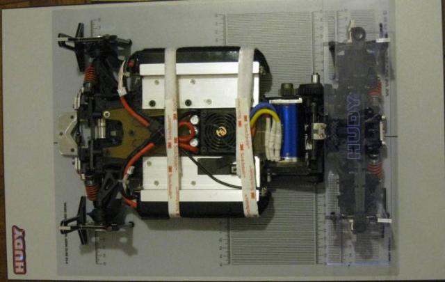

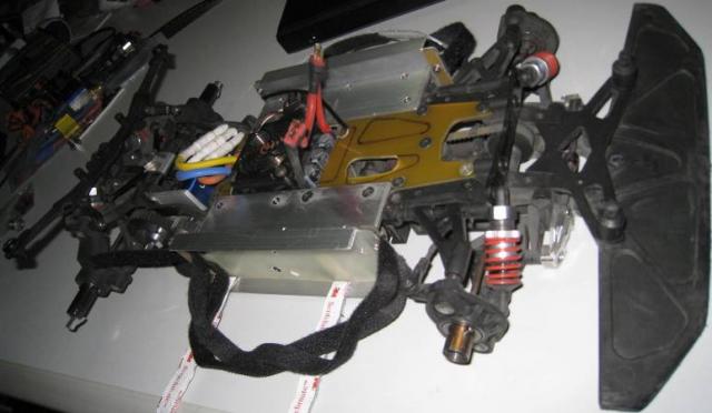

Weight w/o Lipo: 2480g
Weight w/o 4s 6000mah Lipo:3155g
Another test today with 2100kv Losi:
45T s / 19T p
Run Time : 40mins!!
Speed : Comparable to 1/10 Gas Car (preparing to change to 5S or 6S)
Temperature: Motor 52 - 58deg cel. after continuous 10min run (still have around 10deg cel room)
