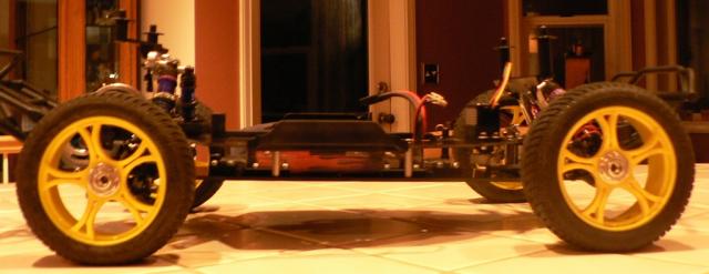

I have these adapters for my slash and they are ok if you put the rears up front and shorten the fronts for the rear other wise you will be breaking steering hubs and caster blocks. I went threw 3 pair of rpm steering hubs and 2 sets of caster blocks before I figured out what was wrong other wise they are a good up grade. Just a heads up before you buy them.
Mike
